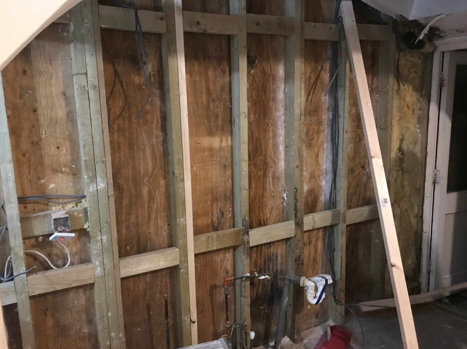

Hi All,
The studs on this wall are 10cm wide - when measured from the block to the plasterboard.
I would like to put some horizontal wood in between the studs to provide a fixing point for my wall and base units.
Would it be okay to use 4x2 for this purpose?
If yes, do I screw diagonally on the face or top and bottom? Will this provide sufficient strength?
Thanks for your help.
you could use 89mm cls timber . cheaper.
screw through the sides of your existing batts.

yes the 89mm facing you.
offset them by 3/4” up and down to get the screws in...do every other one level , then set the rest 3/4” lower so the screws in those will be at the bottom . stronger.

UPDATE: I've put these timbers in this week. I have used my laser level to set the height of the base and wall cabinets.

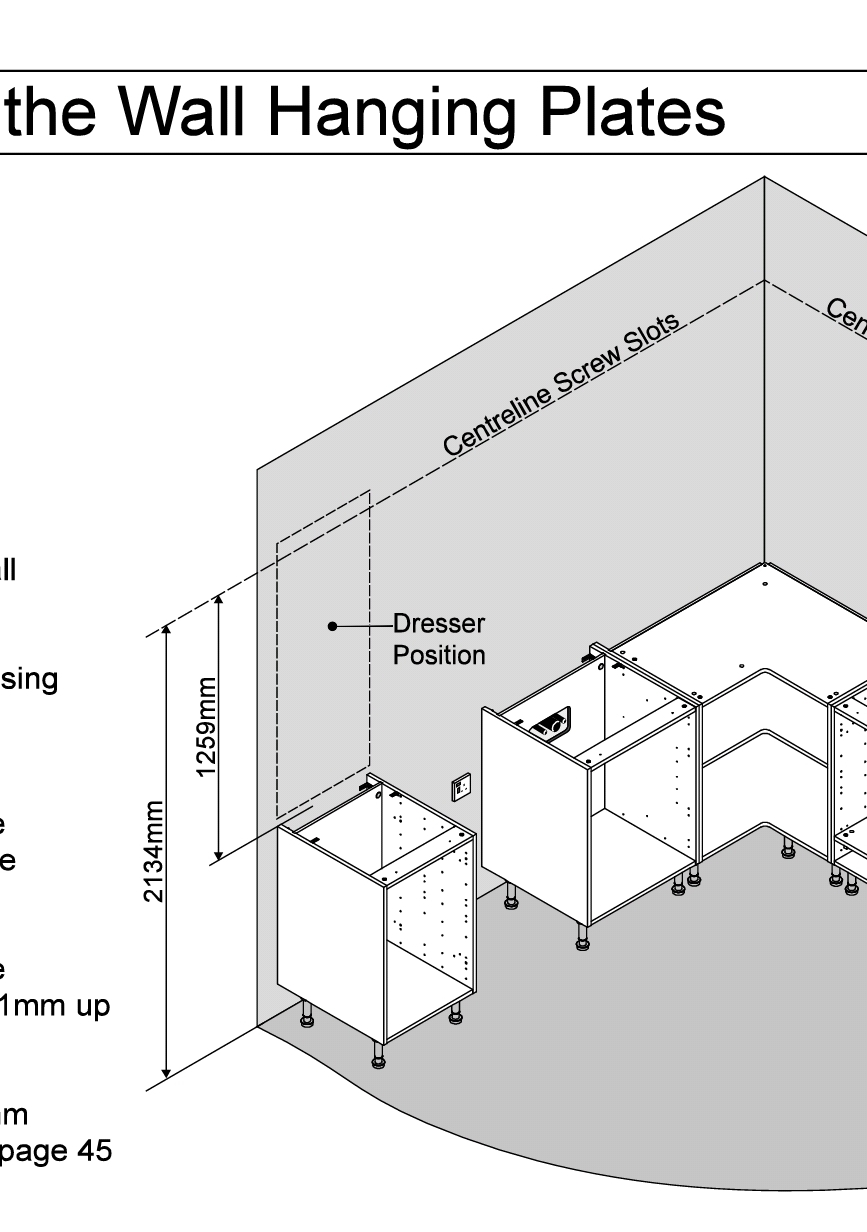

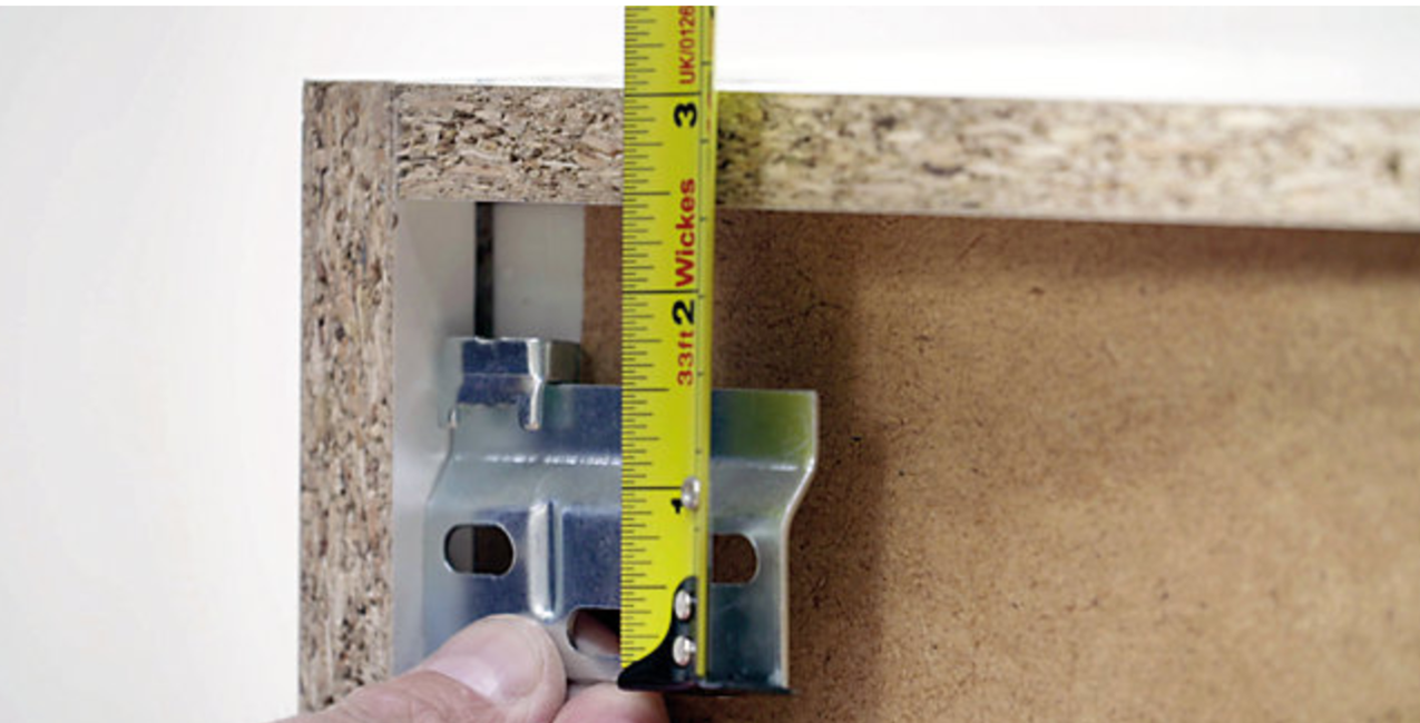

I am fitting Wickes Kitchen units and came across this:
I have set the high level timbers on this basis. Can someone please confirm that this distance from the top of the unit is correct?
Thanks again.
There is normally a manufacturer's guide with all the modular unit dimensions and heights to set the brackets.
If you have a tall unit/larder/ housing, the top of that is the reference point.
