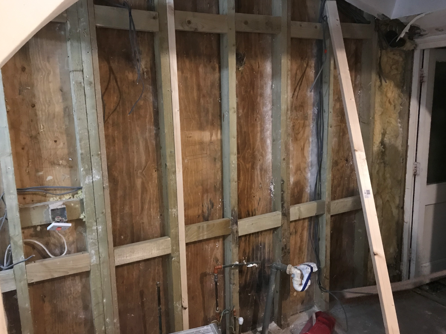

Preparing a wall for a new kitchen
Using wall plates require a slight notch in the Wickes units as I understand it. Doing this invalidates your Warranty. That's the advice I had from Wickes.
To avoid this. I have gone with the batten approach.

UPDATE: I've put these timbers in this week. I have used my laser level to set the height of the base and wall cabinets.

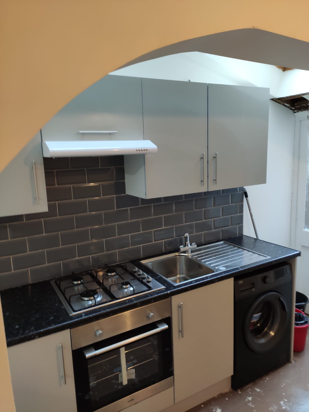

UPDATE: here is a picture of the finished kitchen. Once again, thanks for all your help.
