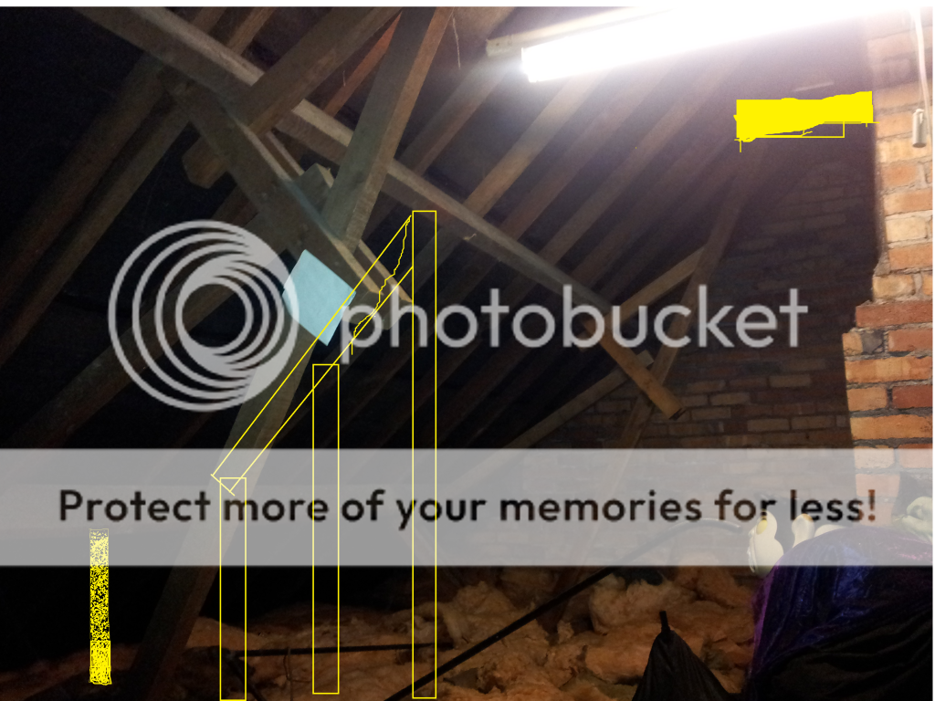

However as you can see from the picture below we have got these timber trusses that we will need to remove, Our plan was to have smaller off cuts of 9x2 going direct from the steel upto the rafters at 400mm spaces. The steels are to be placed 3" above the binder and are going to be in between the wall plate and binder, We were also putting collars I think they are called across the top but these would be quite high in the roof as we need the head height, As the room was going to be only one complete bedroom our builder suggested putting in a stud half way in the loft going from the purlins directly down to the new floor but would leave a 10ft opening so still a nice following space from one end to the other. THe problem I got now though is the S.E has stated today (Retired S.E doing this for a bit of extra cash) the calcs he has given for the steels only allow for the floor load and not the roof so he stated we would need to replace the purlins with steels making a total of 4 steels for a velux loft conversion which seem's excessive to me but I am a bit annoyed that he did not calc the steels to take both the floor load and roof and wondered if someone can have a look and help.

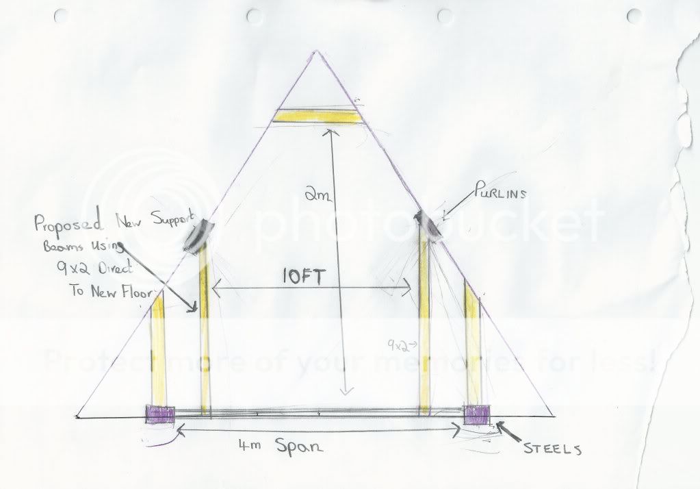

This second image shows what we wanted to do putting in the stud wall

What I will say if their is a poss solution is that where the timber rafters meet the binders directly underneath the binders at those points their is not an internal wall so the weight being placed on the binders surely can't be that much? If we were at mid way in the loft to attach 9x2 joists to those binders and straight upto the purlin at mid point woudl that effectly do what those timber trusses are doing right now and still placed small supports off the steels upto the roof rafters and collars across the top.
Something like this
But isn't your new proposal putting an extra point load onto the floor ... and the beams supporting the floor?
Yes it would, The part of of the stud that goes from the purlin down will go to the binder not the new floor, As they are connected to the binder at the moment which means the binder must be taking part weight of the roof

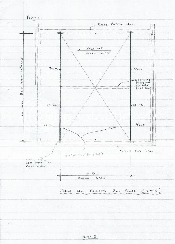

Out of interest what is the serial size of the beams he has specified and what is the span?
I can scan and put them on here or email them to you but I will have a go.
Span is 4m
6.6m between walls
steel size is 8.5" depth (I think)
I will scan the documents and put them up as I don't know what i'm looking at really.

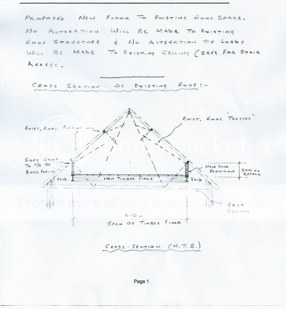

Ok managed to view your calcs on a mobile device.. the first statement on calcs is ridiculous.. not sure how you can have a converted space without modifications to roof trusses unless he was told the trusses would remain as features.. who appointed the SE? If the builder gave bad instructions to him it should fall to the builder to rectify (pay for extra design)..
