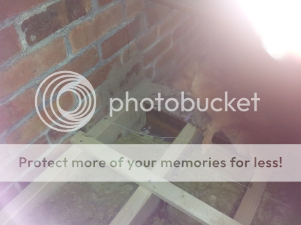

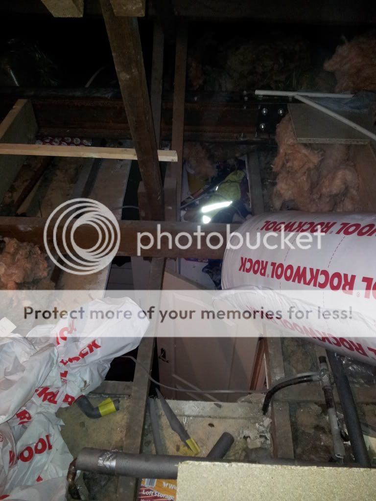

I have attached a picture, This shows the opening we have for the stairway and directly above is where the truss meets the floor, You can see from this angle however that the truss is connected to the binder and not a supporting wall underneath which is the same for all 4 trusses, So my point in making supports within the new loft area as per my diagram above going direct down to the binders is where I plan to put the new supports we want to put them directly over the internal walls fopr extra support so why is that not better than what is their at the moment?

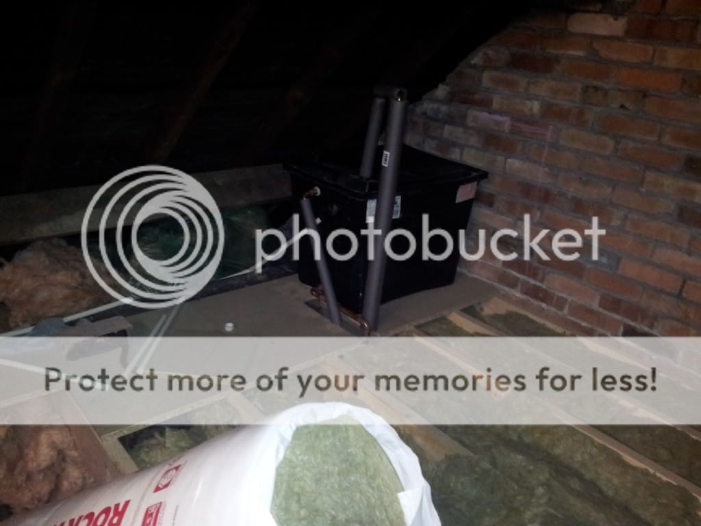

2nd Pic shows the water tank moved to the corner that will be boxes in the fitted wardrobes.

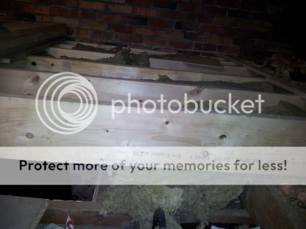

3rd Pic shows the steels cemented into wall on padstones
4th Pic shows how far I have joisted up the 9x2's thus far
5th Pic shows joists inserted into steels you can't see it but they are 3" above the binder
6th pic shows the the 9x2 joists and you can see the gap between the binders and the new flooring.

I can see dowels into the binders, and I would imagine that there is also a connection from the truss to the existing ceiling joist.
What you will find is that the truss isn't being supported by the binder, but is actually supporting it, due to the effect of triangulation. The binder will in turn give further support to the ceiling joists.
So you won't be able to transfer load to the binder once the truss is gone.
The other thing I've noticed is that it's not just the top purlins which are given support by the trusses, but the bottom ones too. Remove the trusses, and the lower purlins sag, imposing load to the new steelwork...but the steels are at maximum capacity already, so you can't allow that to happen...
You need to get support to all four purlins, once the trusses are removed, and that involves more steelwork. One option would be to splice through the steels already in place with more steels (at 90 degrees to them), and send props up to the purlins.
Your SE has cocked up, pure and simple...

Many Thanks for the reply. Ok according to the calculations the steels we have support the floor load only as it is assumed the steel is unsupported through it's entire length, so if this steel was supported underneath from the internal walls that would make it's capacity to handle weight greater thus being able to transfer more weight to it?
I only state this as their is a guy who lives around the corner from me who has the exact same loft as me, He did not do his loft to reg's just did it His steels are only 5'8" depth whereas mine are 8.8" his joists are only 6x2 mine 9x2, He supported his steel by building up from internal walls and transfered the weight of the ceiling direct to those steels and 6 years later after the bloody winter we had last year no problems, So i'm just wondering if their is a way without the expense of an extra £2000 for more steels when I have done everything right thus far getting plans drawn up and structual calcs etc submitting them and yet now I got all this, My house is turned upside down I got the kids squashed into a room until it's done and now it looks like it won't be done
Hmm, if the wall under is sufficiently supported and strong enough then you should be able to use it as a central support for the steels.
That way you would be able to take the load of the lower part of the roof onto the steels.
Then you need to get a calc done to see if your existing rafters will span between the ridge and the lower purlin with the trusses and upper purlins removed. If not (and probably not) get stronger rafters installed between ridge and lower purlins, that are capable of spanning that distance.
Go back to your SE and suggest the above to him, and get him to do the calcs to prove it all works.
