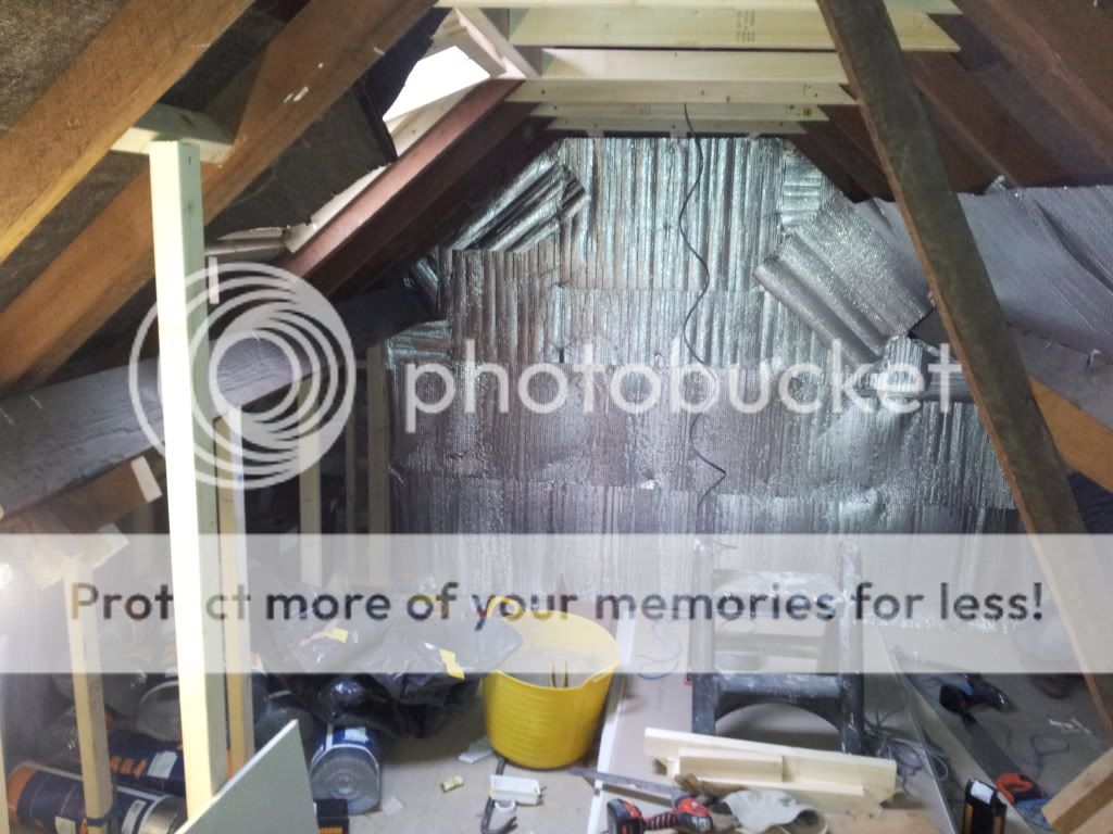

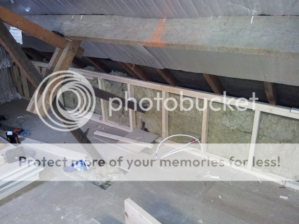

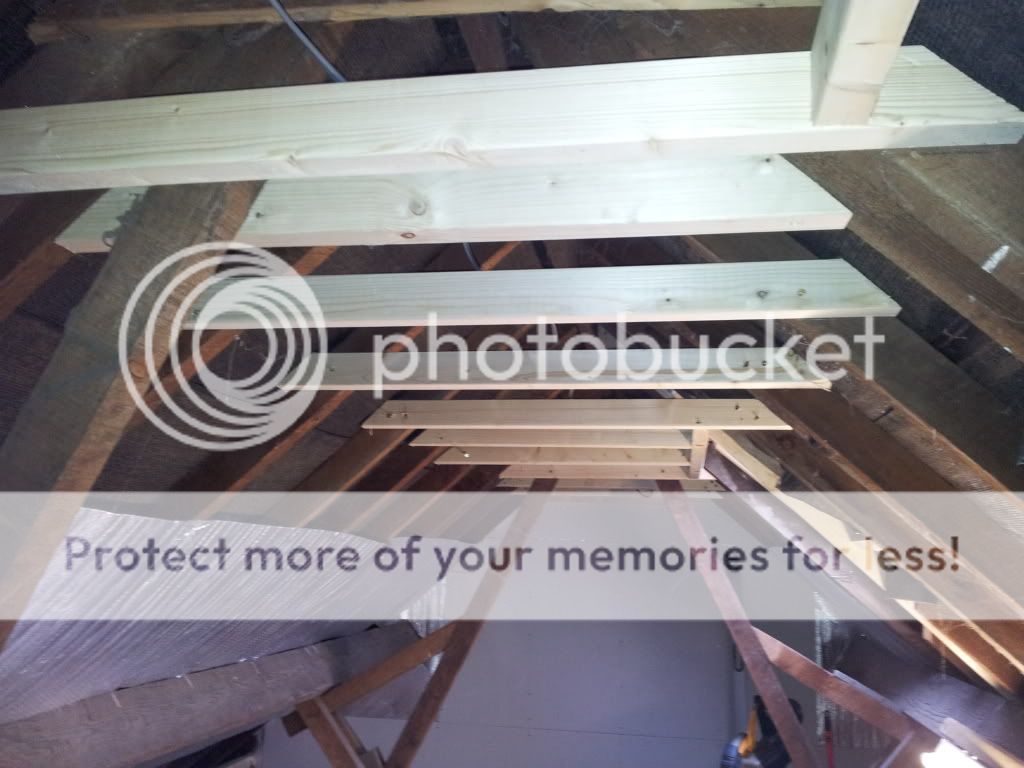

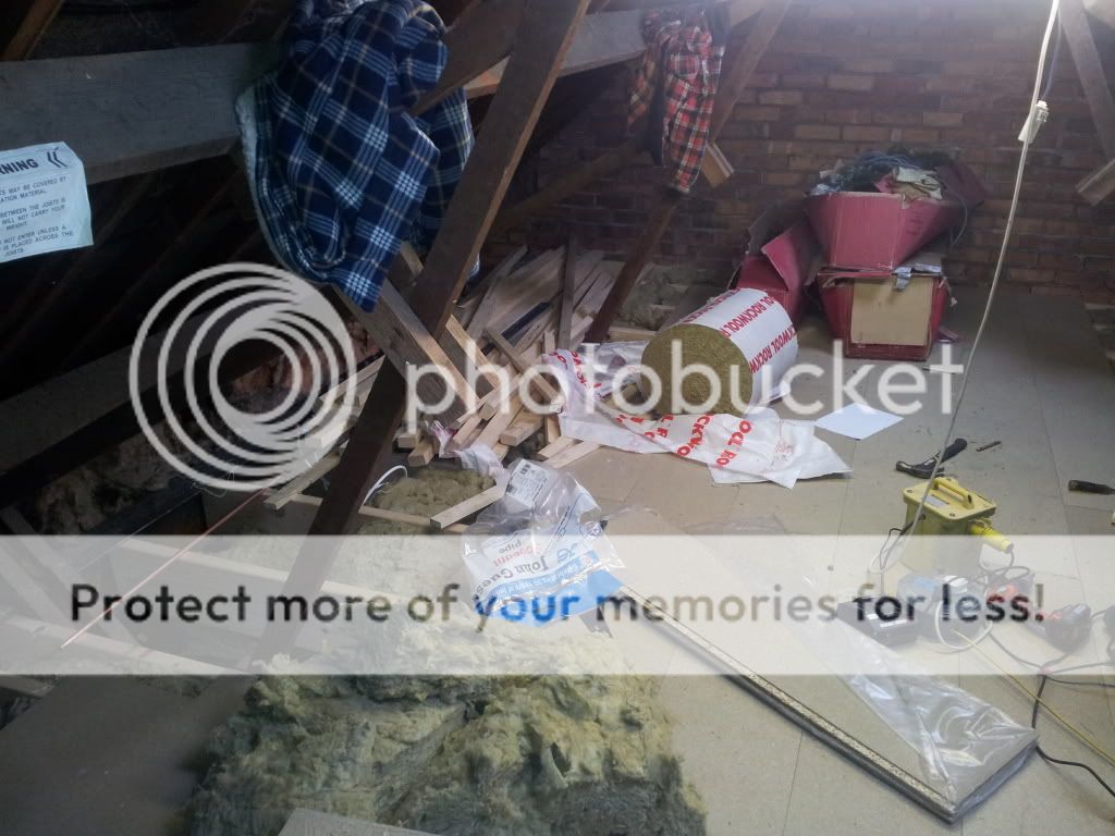

Pictures of current Progress
I see a small problem,
you have not painted the steel in red oxcide paint.
I would have also doubled the rafters and left them single.
