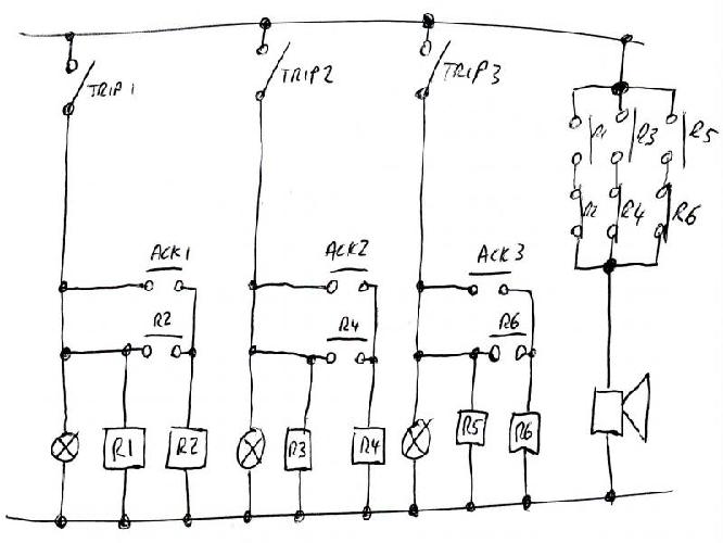

Here is how i need it to work:
There are three aux contacts, if any of the three close (on fault) then the alarm will sound and in turn light the apropriate LED lamp. I need to be able to silence the alarm until the contact is back in its normal state.

Not quite as neat as Mattylads:
R1, R3, R5 need to be single pole, R2, R4, R6 double pole.
There are 3 acknowledge momentary pushbuttons, one for each trip. Nothing to stop you using one 3 pole momentary pushbutton if you want.
When a trip operates the lamp and buzzer sounds, pressing ack silences the alarm. The lamp will remain on and buzzer silenced until the trip is reset. On the right of the drawing, R1, R3, R5 are NO and R2, R4, R6 are NC
As a side note, for important alarms normally closed systems are often used as they are fail safe but as per your design brief, a normally open system is drawn.

How about this then?
The input aux relays latch the RL1-RL3 to keep the leds on, latching required because of the float. The buzzer is powered via a 2 coil set/reset relay that is not silenced until the N/O push button is pushed.
Any other input going active will turn the buzzer back on.
All reset via the main KS/PB & fuse added for the heck of it.

I'm struggling to read the drawing as the letters are a bit small and my laptop only has a titchy screen :(
Does accepting the buzzer inhibit the other two alarms from sounding the buzzer?
No.
Its a set/reset relay that changes state depending upon which coil has 24v on.

I'm looking at your drawing and thinking the bottom relay will be energised all the time once a trip operates. When a second trip operates it will remain in the same state.
Bugger yes! (its been a few years since I last did this lol)
