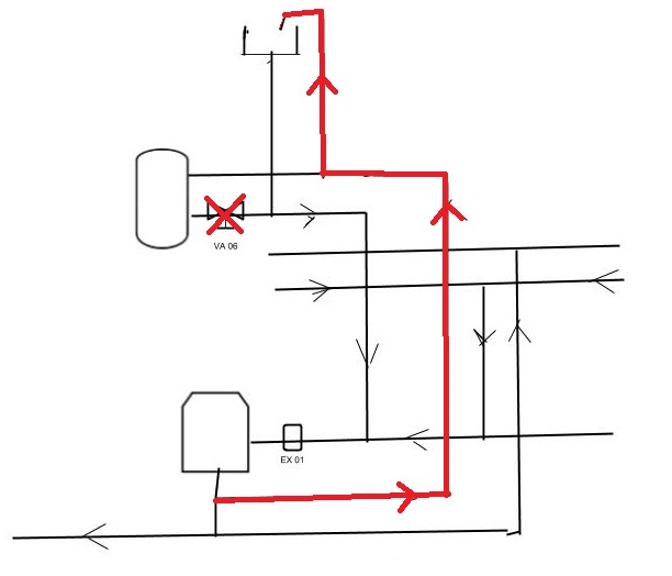

I have just realized that there is a much simpler explanation for the pumping over when the system is running for CH only: it's the easiest path for the water to follow.
When the Valve V01 is closed, there is an open path from the pump to the vent pipe, show in red on the diagram below. The pressure loss along this route will be much lower than round the rad circuit, so water will prefer to travel this way. Result - pumping over.
Frame 3, page 12, of the installation manual gives the requirement for an Open Vented system; yours seems to break many of them, e.g pump on return not flow etc etc. I don't know how Ideal would view this if something went wrong and you claimed under Warranty. Safest to ask Ideal - installer should do this.
Which is why the cold feed and vent should be close coupled on the pump suction.

Please ignore the previous post. I had the same thoughts as you ( D. Hailsham ), namely that the water was taking the path of least resistance - thus the pump over. Thank you for your thoughts on the matter. It is nice to have your views confirmed by someone else.
I would also agree with Simond regarding the expertise of the installer! For that reason I shall be cleaning and flushing the system prior to fitting a zone valve in line with an S plan. I shall probably combine the feed and vent pipes hoping that this will solve the pump over problem.

Cut and cap the cold feed where it enters the system , re-route cold feed and tee it into open vent within roof space.
Yes Steelmasons, I intended to do just that to combine the feed and vent pipes. I shall refrain from going down the historical path - just in what decade the system layout that I have was deemed to be an acceptable/standard design.
As, D. Hailsham pointed out when referring to page twelve of the Mexico manual, it states clearly that the pump must be on the flow side.
Would putting the pump on the flow pipe make any difference to the problem of pump over ?? I am loath to change over at this time - not the best time of year to go without heating and it may be worth while getting an expert in to do the job. For me the easiest route would be to combine the pipes.

Update; feed and vent pipes have been combined and air vent fitted - no longer pumping over.
Contacted Ideal tech. team concerning the pump on the flow side, as indicated on page twelve of the manual, their reply was, that the pump could be fitted on either the return or flow side.
