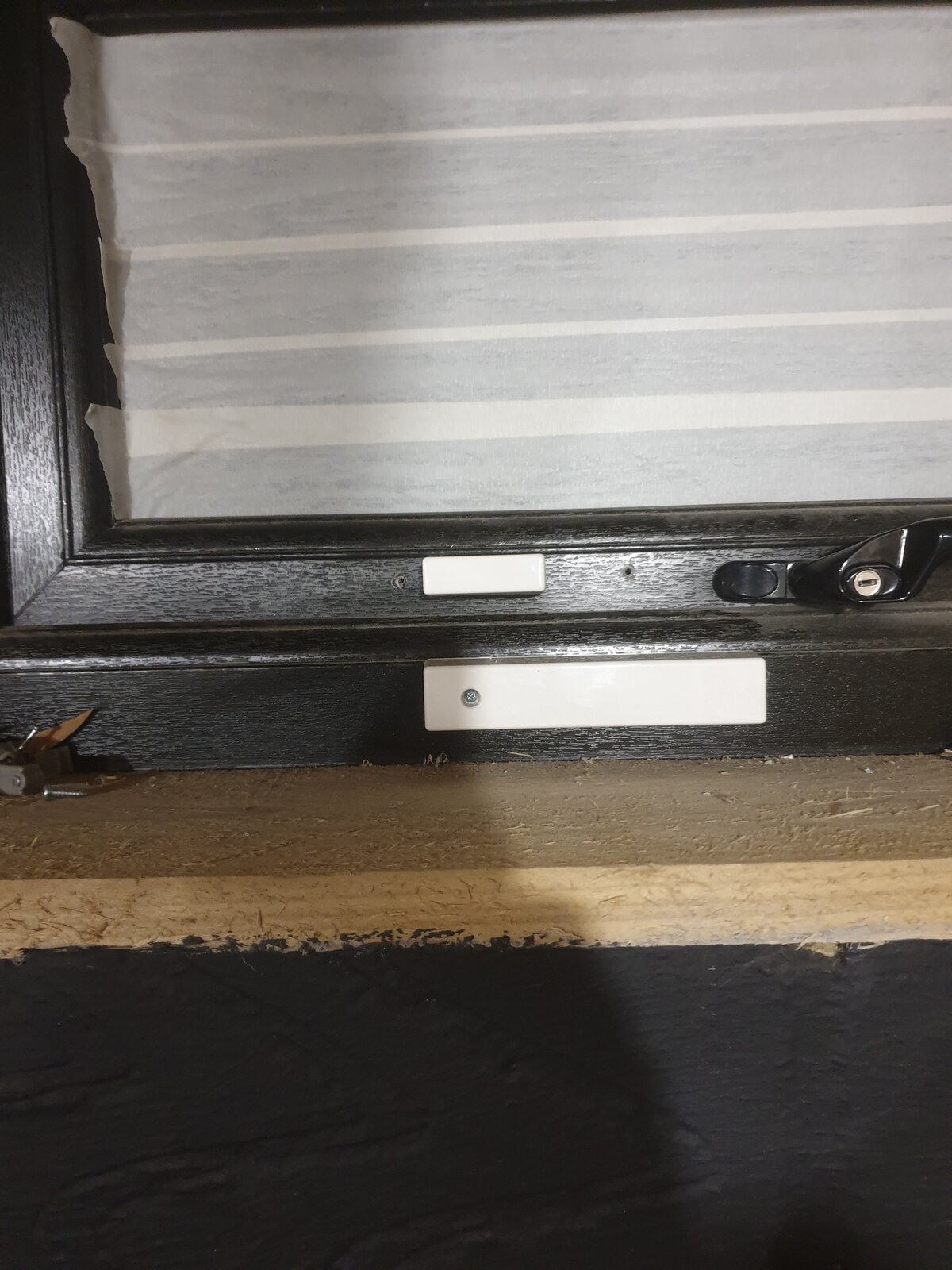

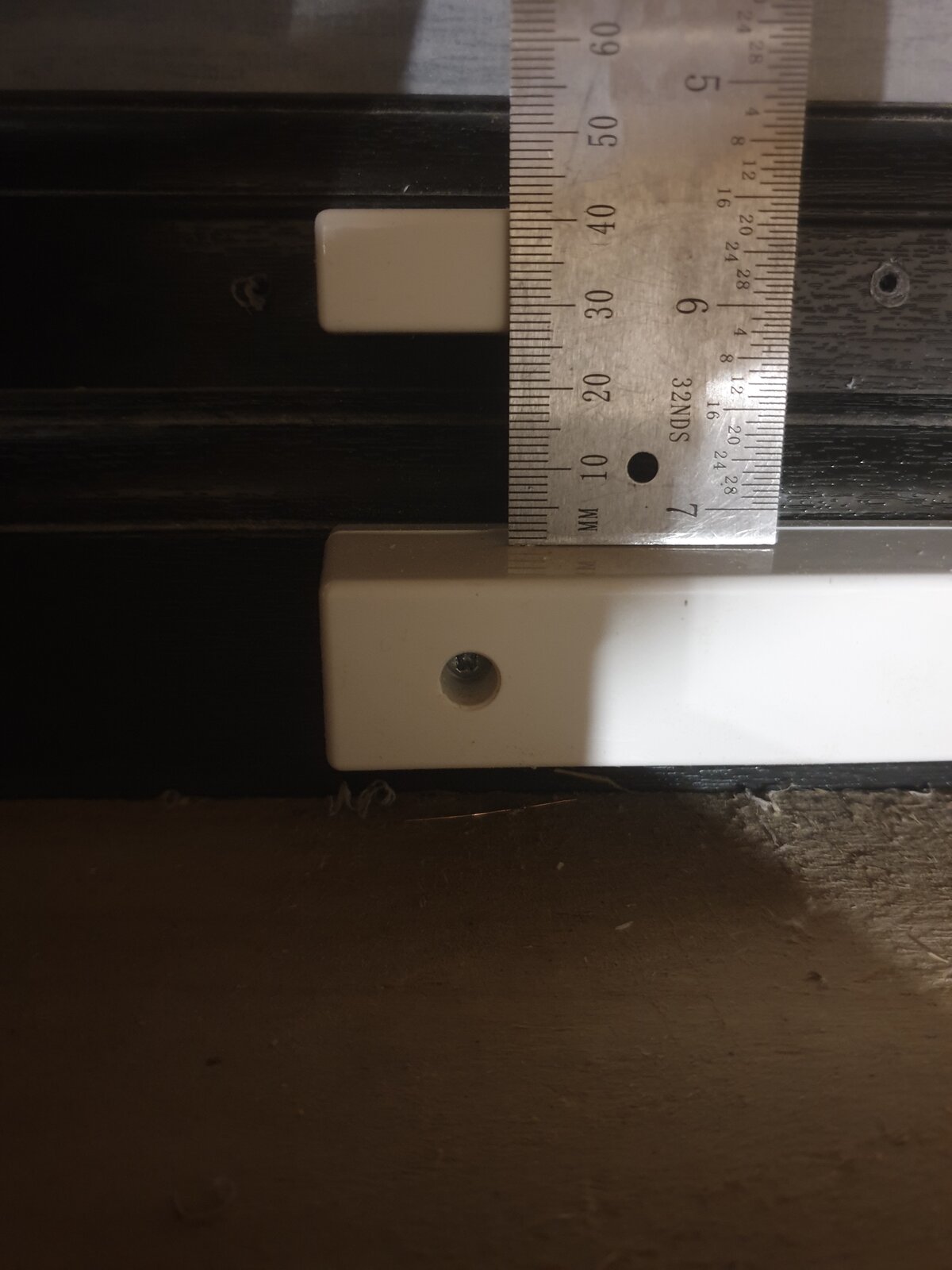

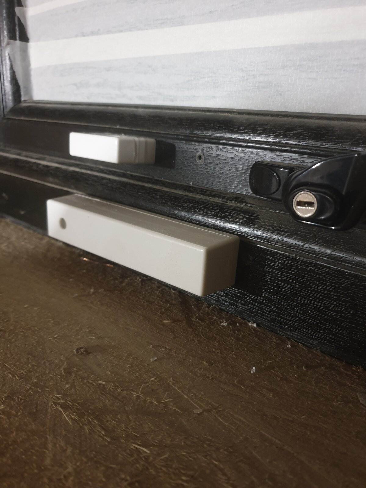

I was able to programme the shock sensor to do both but had to space out the small contact on the opening part of the window from the contact on the frame. Allowing for clearance for the window to open, they are to far apart so is doesn't pick up the window opening. They are just shy of 30mm apart. Is this a common issue with upvc windows.

Issue with the shocks doesn’t seem right. Do you have a photo
Photos below

Also post photo of device fitted to door.
