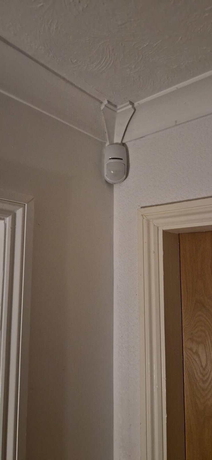

Pyronix enforcer
It lights up when I walk in front
The whole system was working fine until I couldn't add a fob. I reset and had to add the inputs, but it deleted some settings
Did you have to relearn all the devices? Can u do battery test in diagnostics
No after I did that the system was working fine until I tried to get B working and made some adjustments as per this forum.
I cant do it until the morning, ii will post then, but I replace the batteries every year last done in May. Its not batteries its a setting somewhere.
There is no setting to stop your pir working in a walk test. Unless the zone is isolated, in which case you would have had to delete it in the wireless device menu also. If it is correctly programmed as ER (FX) and assigned to areas A + B with input area 'ANY' and not on double knock or soak test etc etc then it should be working.
Really appreciate your help I know its not rocket science I just can work it out. Need to check input area
I don't have an option to . Input areas any.after input areas it goes to attributes
I cant do previous until morning due to bodies in the house
When u get to input areas in change inputs it will either say any or all
I have done a walk test and the hall now passes but one of the others now doesn't work. I can't get to change inputs
I have a manual to the WiFi version and it says just what you are saying, not sure why it's missing from this menu
Take the lid off the one that’s not working ….if it goes off tamper ….it’s programmed onto the panel …
