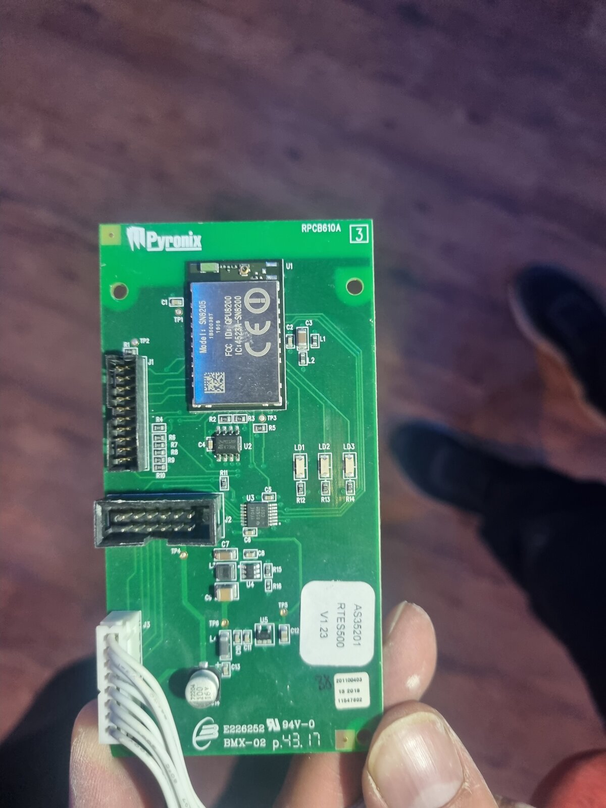

Wifi card is inside the box, tried moving card out of box still have same problem, I don't think it will take an aerial
Wifi card
You need a digi-wifi-xa (external ariel). The one you have is for an enforcer panel which is ok as it is in a plastic enclosure

Well he should do as he shouldnt have put it in there in the first place
