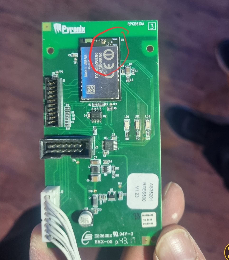

It's been ongoing from day of install but he said it was down to broadband
So he didnt come to check the system at all? Does this person specialise in alarm systems, or does he also do window cleaning, painting and decorating, and tv aerials
To be honest I can't be ar$ed arguing with people just need it resolved

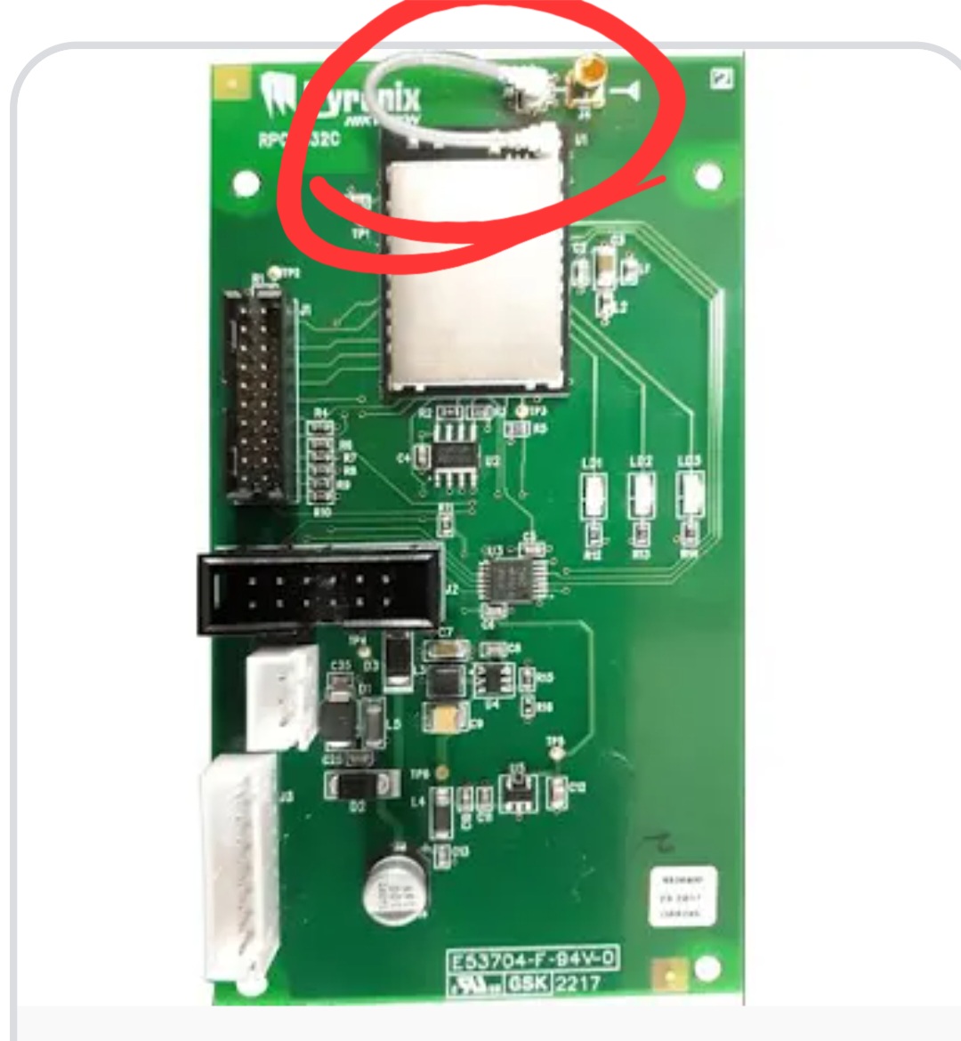

Oh dear. Will cost u about 100 quid for a digi wifi xa. Place the ariel away from the metal panel. But would definately request the installer to fit the correct modem before wasting 100 quid of my own money
Also, if your going to do it yourself, make sure to fully down power system before unplugging old modem and plugging new modem in.

Lol …some tool has fitted the wrong WiFi card ….how did he expect that to work inside a metal box ? I wonder what else is wrong with it

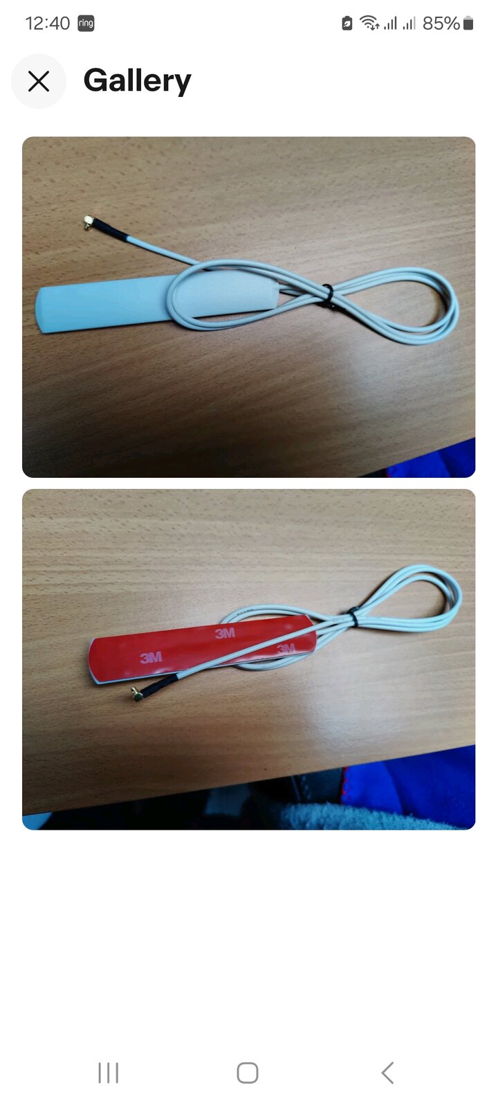

Question mate, will this fit the card I have in my box? I bought it a few weeks ago on ebay but not sure if it is compatible
