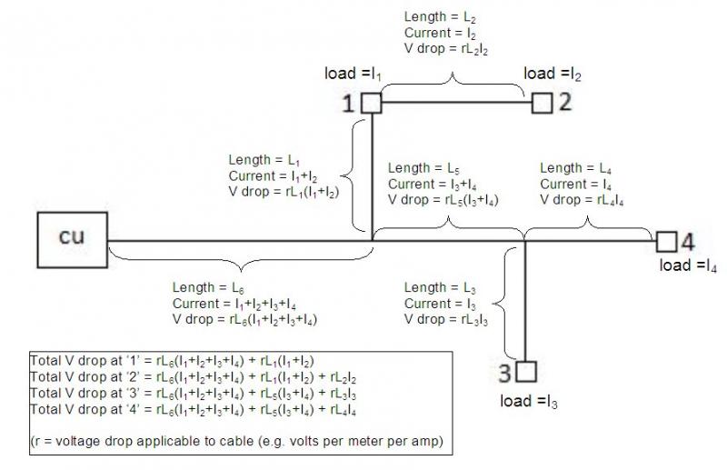

OK. Further to my recent post, please see the diagram below, which relates to the example circuit you originally posted.
I have called the currents drawn by each of your four circuits I1, I2, I3 and I4, and the lengths of the various segments as L1-L6, as indicated on the diagram. What you have to do is to work out the current in each of those cable segments, then multiply that by the length of the segment and the appropriate figure for resistance of the cable (which I've called 'r' - e.g. 18 mV per amp per metre for 2.5mm² T+E cable) to get the voltage drop in that segment. Having done that for all of the segments, then, for each socket, you add up the voltage drop in each of the segments which form part of the path between that socket and the CU to get the VD at that socket. Having done that for each socket, you can look to see which is the maximum. All of that obviously requires that you know the currents being drawn at each socket (and lengths of the circuit segments).
If it's the maximum possible VD at any socket which interests you, then you obviously have to decide what arrangement of currents will result in the maximum possible VD being seen at one of the sockets. For a simple circuit like yours, I think the maximum VD will occur (at the socket with the longest path), when the socket with the longest cable path back to the CU (which, depending on the layout, could be any of yours other than socket 1) is carrying the maximum permitted current, and the remainder of the 'available current' is drawn via the socket with the next-longest path. If it were a 20A radial (i.e. 20A MCB in CU) and the sockets were all single, then that would arise when 13A was being drawn from the furthest socket and 7A from the next-furthest one.
Does that help?

JohnW2 that diagram is EXACTLY what I have been looking for! Makes it all much clearer to fully understand rather than trying to follow written instructions. Really sorry that I was unable to reply sooner. I really think there should be a sticky regarding volt drop and the principles involved in order to calculate it in simple and complex circuits. IMO one doesn't need to involve the flow of current unil they understand the method of calculating each 'leg' in the circuit concerned.
All I wish to do now is experiment with different amperage which will consist of made-up figures and I will apply those to some sockets to achieve the volt drop for each cable leg. I presume then once I have gained the volt drops for each cable leg, I tot them all up and if they exceed 11.5V (5% max permitted voltage on a 230V in supply installation for power circuits), I can apply methods such as changing the size of conductors/ lengths etc to decrease the total volt drop in order to meet volt drop requirements. This will be a great exercise for me to gain familiarity of the calculations involved. Many thanks again for that diagram :D

One certainly has to first understand the underlying concepts/methods. However, your question appeared to be about the 'maximum possible voltage drop in the circuit' (which, depending upon the situation, could arise at any socket**) - and you obviously do need to know both the currents and the 'leg lengths' to be able to work that out.
[** the maximum VD could only arise at socket #1, jointly with #2, if there was zero load at socket #2]
Indeed. In this day and age, the nicest way to do that would be to set up a spreadsheet that would allow you to specify each of the currents, each of the leg lengths and each of conductor sizes - then you could play with all those factors to your heart's content and instantly see what effect the changes have on all the voltage drops (and the maximum). If you want to try that, and want any help with it, just let me know.
