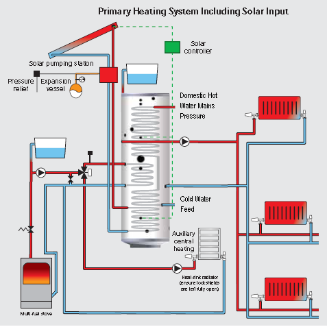

a solid fuel appliance heating HW requires a pipe Thermostat that activates a pump, and pumps the excess heat to a heat dump, usually rads but can be others

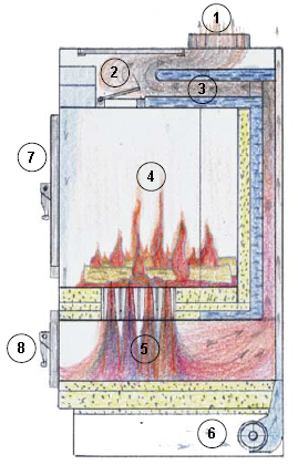

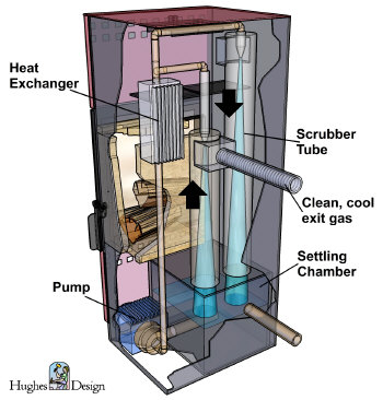

I have seen plans Torrent pipe example.PNG showing this radiator however not seen any pump and can't see how a pump would be safe same with boiler needing a pump. These two wallnoefer.PNG and Hughes Condensing Stove 2 small.jpgboth seem to need electric to circulate the water, I remember writing to one manufacturer asking about this and never got an answer, my son with a narrow boat did use a pair of 12 volt DC pumps and a pair of pipe thermostats to switch them on one powered from domestic battery and one from engine battery so unlikely there would every be a problem powering pumps.
However with a header tank in the loft space thermo-syphon with allow the hot water to heat the header tank, and as long as the tank can take boiling water if water boils there is just a lot of noise and boiling water is ejected out of the over flow, I well remember the water spurting out onto the drive at dad's old house, by time it reached head height cool enough not to be a danger.
