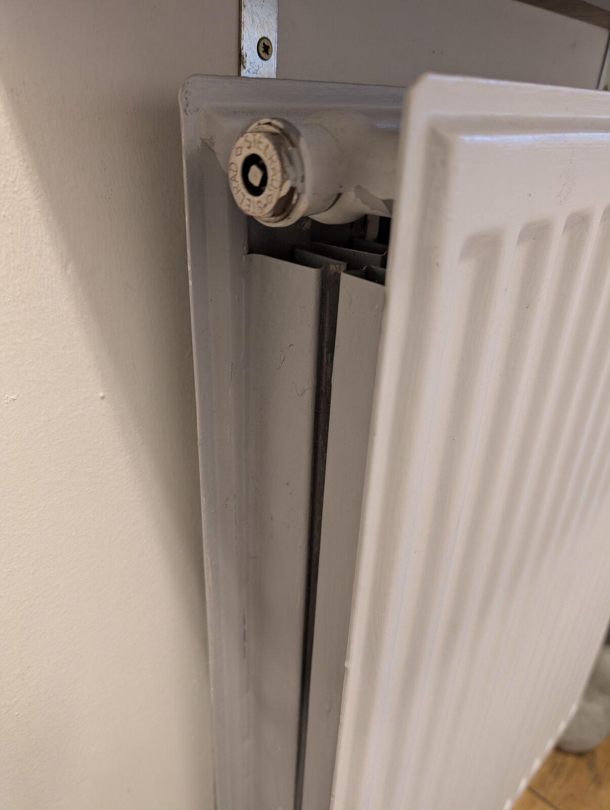

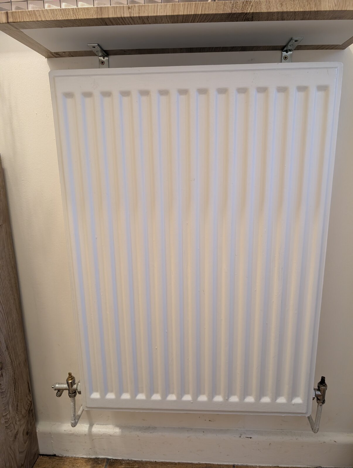

We are trying to optimise our older (1995 ideal classic) heat only system as the temps are dipping before getting a new system next year. Have noticed that the radiator in our hall way is not as hot as others around the house.
This is where the thermostat is located, so would really like to sort it
Theres no trv on it which seems to be a common thing for this location
I've bled it and no air, and the inlet pipe seems to be getting almost as hot as others on the system.
Any ideas what I should try next please?

You say it is near the room stat and has no TRV.
This is correct, and it is supposed to be the last one to get hot so that the CH is not turned off before the rest of the house is fully warm.
It has probably been adjusted by balancing. This is also correct.
You could rebalance it to get hotter, but this would result in other parts of the house being colder.

There is a valve, one on the flow side, one on the return. One, or other, or perhaps both, will be restricting the flow through the rad. If you want that radiator warmer, then it needs more flow through it. To achieve that, just try opening both valves a fraction. Closed is clockwise, open is anti-clockwise, as viewed from the end of the valve spindle.
Mark their positions, before you adjust them, so you can return them back, to as they were.

Do you have TRV’s on all the other radiators? If so then once they all get to temperature and close the rad in question will get more flow and should heat up more.
Not TRVs they are all manual valves around the house. Pretty sure all are at least 3/4 open. There are 2 without adjustable knobs - one of the lounge rads and this one in the hallway. Unless of course, the heads have been removed in the past..

The left is the lockshield valve isnt it? adjusting that could mess with the balancing of the system. I may just try opening the inlet a but more with pliers
