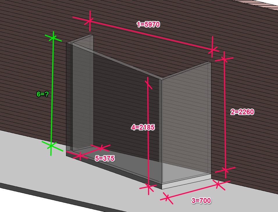

If you tell me what dimensions 1 to 5 are I can tell you the elusive No.6 ....
This assumes your two side walls are perpendicular to the house wall?
Thanks for doing this. Included some comments for clarity.
1 - external measurement is 597 but I will have a slight overhang on the left side. Can't do the same on the right. Let's call it 602cm?
2 - 218.5cm from the top of the base to the header stud
3 - 70cm measured externally
4 - same as 2
5 - 37.5cm measured externally
Also, 6 currently is the same height as 2 and 4, as seen in the earlier images.
Look forward to your response and thanks again.

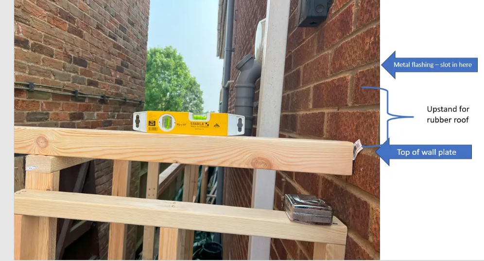

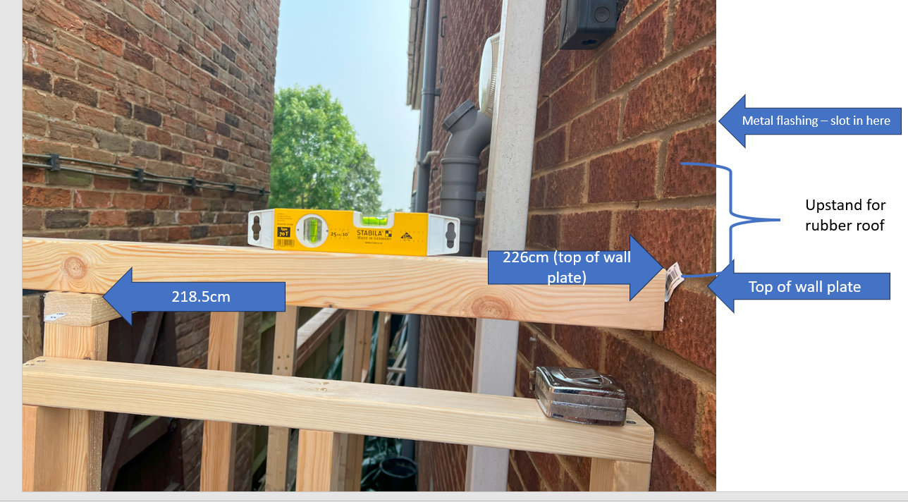

Back to this, the side panel is now built up to the same height as the stud at the front, 218.5cm. The top of the wall plate will be higher than this (as indicated b the rafter in the above image) and that's what provides the above fall. I will then fill in the "triangle" on the side.

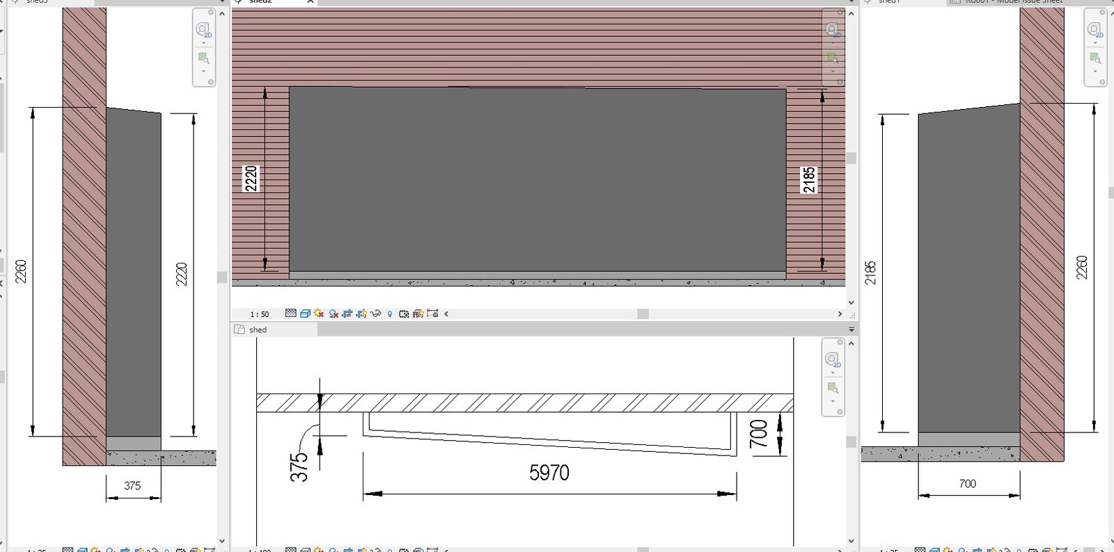

OK lets try this, what will the height difference be in mm between the roof at the back and the roof at the front?
On a related note, your drawing appears to suggest that I can crack on with putting my wall plate at my proposed level and have it dead straight? Any adjustments will happen on the header plate if I am following this.
The wall plate on the wall must be horizontal yes.
I will start to get this in as i can use this to hang tarpaulin and provide some protection from the upcoming rain. Once I have the updated measurements, I can consider how I get the necessary elevation.
Your elusive dimension is 2220mm:

How can I start on the right with the first rafter and then level the next one and one and on? Can I use plastic spacers to raise the rafters as I go? This approach will give me more control over this and if my wall/header plate are not completely level, I can make the appropriate adjustments as I go along.
I am unsure how I do this as I don’t think the spirit level is much help with the rafter arrangement.

Another way you could possibly tackle it, is by simply sighting along the timbers, to perfectly match the angle. Either using a digital angle gauge, or one person adjusting, whilst a second person sights along the timbers, so they match accurately, before marking and cutting.
Fix your wall plate timber perfectly horizontal. Fix the vertical support at the 700 wide end, then the first joist in place. That sets your initial roof angle.
Move to the rear, and temporarily install that vertical, and fix the joist to the wall plate. Now adjust that joist, until the angle of that joist, perfectly matches that of your first joist, either by sighting, or the angle gauge, then mark and cut.
The in between joists, simply follow on.
