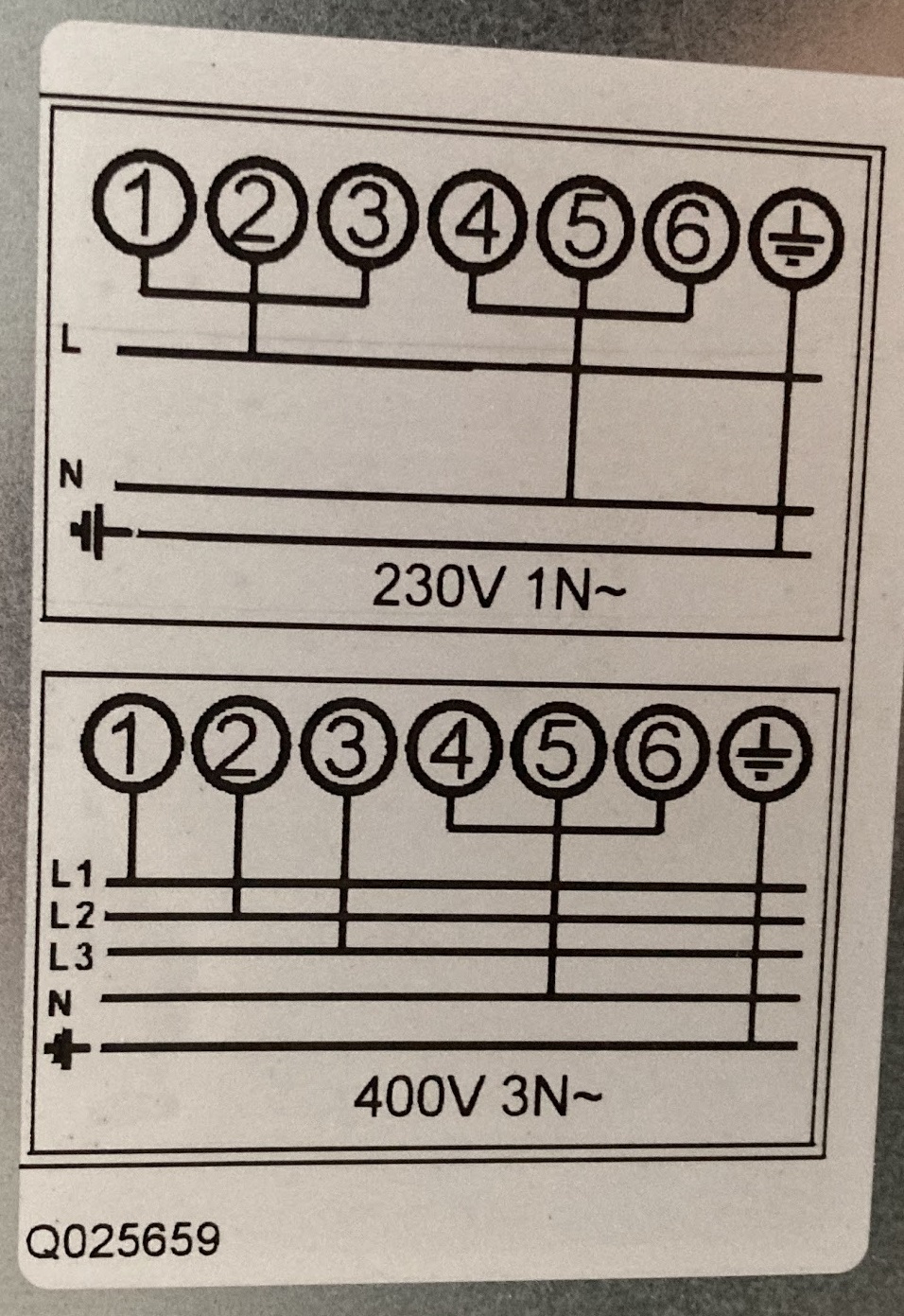

Hi,
My property has a 3-phase CU and my new range cooker appears to offer the option of being wired as single or 3-phase (connection diagram attached). The electricians have installed two cables aiming to share the load for a single phase appliance (they didn't know the cooker would be capable of being wired for 3-phase). My (Schneider) CU uses RCBOs for each circuit so I'm guessing it's going to be expensive for a 3P RCBO...
1. Are there any advantages to having it wired as 3-phase? I thought it might be the case that I use everything all at once on full power (however unlikely)
2. What happens if one phase fails? I'm in a rural area so when there's the odd power cut, it usually affects just one phase.
Thanks :)

1 - the advantage is that it spreads the load across all 3 phases, and the size of cable required between the consumer unit and the cooker will be smaller in cross sectional area but have more cores in it.
2 - if one phase fails and the others don't, then anything that uses 3p will not work properly or at all. Some devices could be damaged, but that's not particularly likely with a cooker.

Yes, it is something like that (nearer 65A at 230V if the 16.24 kW is at 240V) ... or 28A after diversity - and even that only if all parts of the cooker (presumably including at least two ovens) were being used simultaneously
One could use 3-phase but, at least in theory, one could use a 32A single-phase circuit.
I would think that any advantages of using a 3-phase supply would be pretty minimal.

OK - I was just looking at the cables and I believe they're both 6mm T&E so they should handle the power using 3-phase or single phase just fine. It would be interesting to see the wiring inside the appliance and based on what's been said here, I'm going to drop the manufacturer an email to ask for more information regarding the potential failure of one of the phases.

If it is wired as 3 phase failure of one phase just means that those parts of the cooker on that phase won’t work. Of course if wired as single phase and that phase fails none of the cooker will work.
I see a number of downsides to wiring a 3 phase supply for a domestic cooker.
1. Space in the distribution board. A 3 phase MCB takes up 3 times as much space as a single phase one.
2. RCD protection, most brands don't do a 3 phase RCBO as-such. Schnider do a "Vigi" unit which clips onto the size of a MCB and effectively turns it into a RCBO, but it's expensive and means your MCB+VIGI combination takes up 6 modules of space! Now strictly speaking cookers don't need to be RCD protected, but if the cable is concealed in a wall or partition then practically it needs to be either RCD protected, run in steel conduit, or run in a cable type like SWA that incorporates an earthed metal layer.
3. Local switching. While i'm not sure if it's a regulatory requirement, the normal expectation in the UK is that cookers will be provided with a local switch/isolator. In a domestic kitchen, the expectation is that said switch will be a flush mounted accessory matching the others in the kitchen. Practically every range of accessories will offer DP plate switches and Cooker control units, TP+N plate switches are far more esoteric.
You seem to be assuming that the loads (e.g. heating elements) within a cooker supplied with 3-phase are all wired as single-phase loads (i.e. P-N). Is that necessary the case (I have no idea)? If not, then I would imagine the behaviour if one phase were lost would be less predictable, wouldn't it?
Given that the manufacturer gives the option of wiring the cooker as single phase, I think it's reasonable to assume there are no loads wired P-P.
