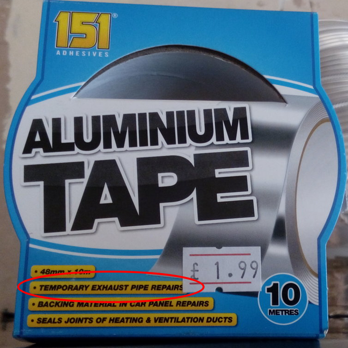

Like this stuff, you mean?
Erm, you circled the bit about temporary exhaust pipe repairs. I suspect that they might mean car exhaust pipes. Then again I could be wrong. Their products are sold in PoundLand (speaks volumes).
Unfortunately they don't even bother listing the specs for their products on their own website (again, speaks volumes), hell they don't even bother listing their products.
http://www.151.co.uk/
I share your suspicion.
And I contend that a product which can be used, even temporarily, on car exhausts can probably cope with the temperature of a cooker hood duct.
Of what does it speak volumes?
