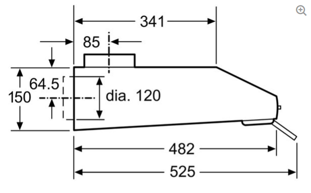

Apart from the electric advice already posted,the duct install could have been done differently.
Usually those hoods have a rear duct exit,personally i would have used the rear duct with a short length of suitable smooth pipe and suitable flap louvre vent.
This method has the advantage of keeping the pipe as short as possible,smooth pipe will not trap grease and condense in the corrugations and a slight down angle towards outside will prevent any grease/condense entering the extractor. Periodic cleaning of the pipe is recommended.Internal cleaning of the hood is essential.
If the extractor has Aluminium mesh grease filters they do not stop all grease entering the extractor,fleece/charcoal mat filters offer more filtration.
There could be an external obstruction on sirlancelot's external wall,existing wall apertures do not have to be used :idea:.
Yup.
the rear duct seems to being discontinued on newer hoods. I got an Elica in a model that was listed as top-exit only. In fact there was also a rear port but it was blocked off by the plastic moulding of the "snail." There were instructions for tearing it open, but the snail design was such that the top port had much better airflow. Their canopy models are all top-port. This is a bit inconvenient if you already have a duct through the wall positioned for a rear port.
I'm pretty sure the large pipe was because for some reason the op could only reduce to 100mm or increase to 150mm, and the outlet was 125. I think opinion was split on whether smaller was a problem for noise/efficiency/back pressure. Personally I'd always maintain at least the original size, it's not quite like a foul drain but even so I'd let it flow freely

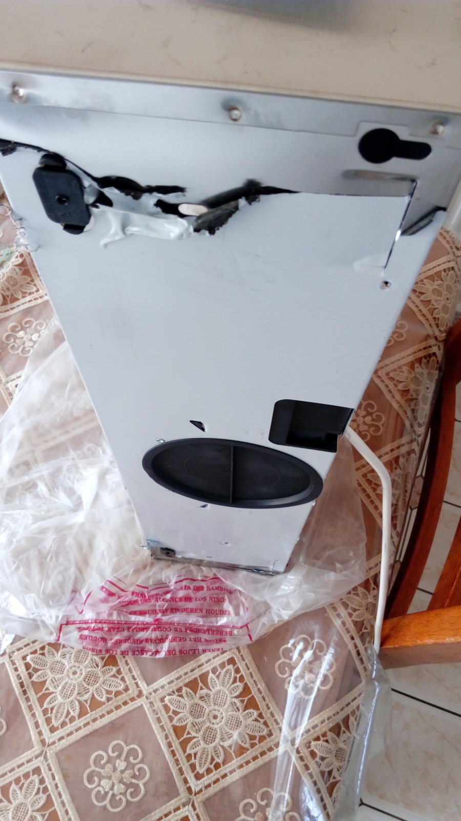

Need some help understanding something:
He did't removed the plastic film covering the rear of the unit, that contacts the wall:
(Pic was taken when the unit was being unpacked pre-install).
It's currently there on the rear of the unit - as installed.
Is this protective covering supposed to stay on the unit after install - or was it supposed to be removed?

After the unwelcome approach of a select few fellow members on the forum - I got up on a step ladder - and took a look today. The plastic can be seen in the original pics - poking out the top - of the unit.
I'm asking - should this be there?
Film doesn't matter it's just too protect the finished metal sheet from scuffs, they just bend oi into the right shape for the hood and leave the film for the customer. Obviously scratches on the back don't matter but the metal manufacturer doesn't know, there's no need for anyone to remove it at any stage later as it's hidden. Hope this puts your mind at rest.
Don't over think things you'll cause yourself more stress than the danger caused by any installation issue.
If you are concerned about the cable sitting on the extract, put a screw in the wall and cable tie it to that.
The tape packaging states for sealing heating and ventilation ducting, so its being used for its designed purpose. If you are concerned, prob best to ask a ducting supplier.
