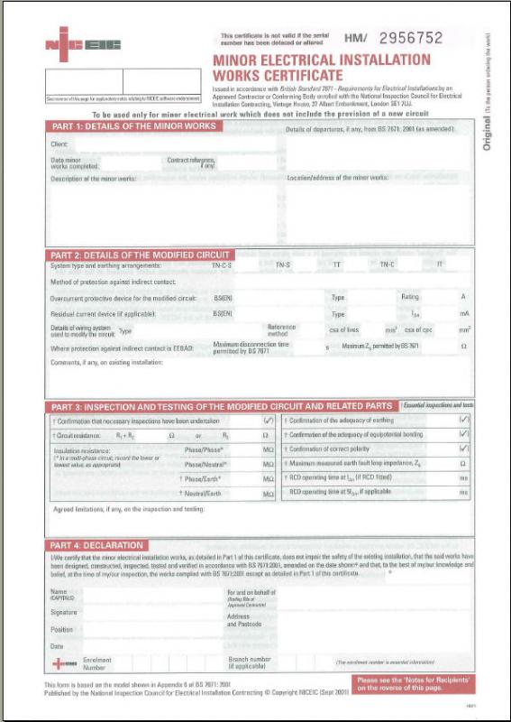

IMO a Minor works cert is fine.
Part 1 is a description of the works.
Part 2 covers the details of the installation which would include the existing/new protective device(s) for the circuit.
Part 3 covers the testing of the circuit which would be after the new protected device(s) had been fitted.
Part 4 is your declaration that the works detailed in Part 1 will not impair the safety of the existing installation and that the works have been designed, constructed, inspected and verified in accordance with 7671
What other information would be relevant?
Maximum demand, characteristics of supply, supply fuse type and size etc.
NICIEC book on I, T & C (16th ed regs) has a table of what is acceptable and what is not, in their eyes the replacement of a protective device not on a like for like basis is not an acceptable use of a MWC.
That does surprise me. We've been changing B's for C's and some cases C's for D's for years on a MW cert. Not once has this come up during an audit. :confused:
Why would you fill out an EIC if you changed a 32 to a 20?
IMO that's why Part 4 is on the MW cert.
I have always understood changing a protective device is altering the protective characteristics of the circuit so the MWC isn't suitable. There is no space on the MWC to record the necessary i.e. Ze, R1+R2 etc which you would to do anyway before deciding it is suitable to energize the circuit. I can understand the reason why when you are making it conditions more onerous i.e. if you are changing from B to C or increasing the size, fwiw I think it is daft that a full EIC should need to be done for down sizing an MCB.
Maybe worth consulting with your scheme to see there stance.
It doesn't include Ze or maximum demand :(

How do you know that a 32A Type B device was appropriate in the first place? Where do you record the results of your testing to confirm it is? Where do you record the results of your RCD testing?
Yes, you can attach a schedule of results to an MWC, but the lack of any text on the certificate referring to attachments makes me think that an MWC is not the expected form for you to use.
If you have the NICEIC Inspection, Testing and Certification book (I have the 4th ed) the table I referred to before is in chapter 4.
I have a copy of that great book but I do think some of their recommendations assume a lack of “electrical common sense”.
For a straight forward final sub-circuit protective device change I would still use the NIC MWC.
As long as the circuit Zs is measured and conforms I can’t see the need to record Ze, bearing in mind that for most commercial installations it's normally "by enquiry" anyway.
I would also argue that if the circuit being modified had a detrimental effect on the total load/maximum demand of the building then it shouldn’t be done as it would make Part 4 invalid.
Where do you record the measurement, and in the case of an RCBO the operating time?
