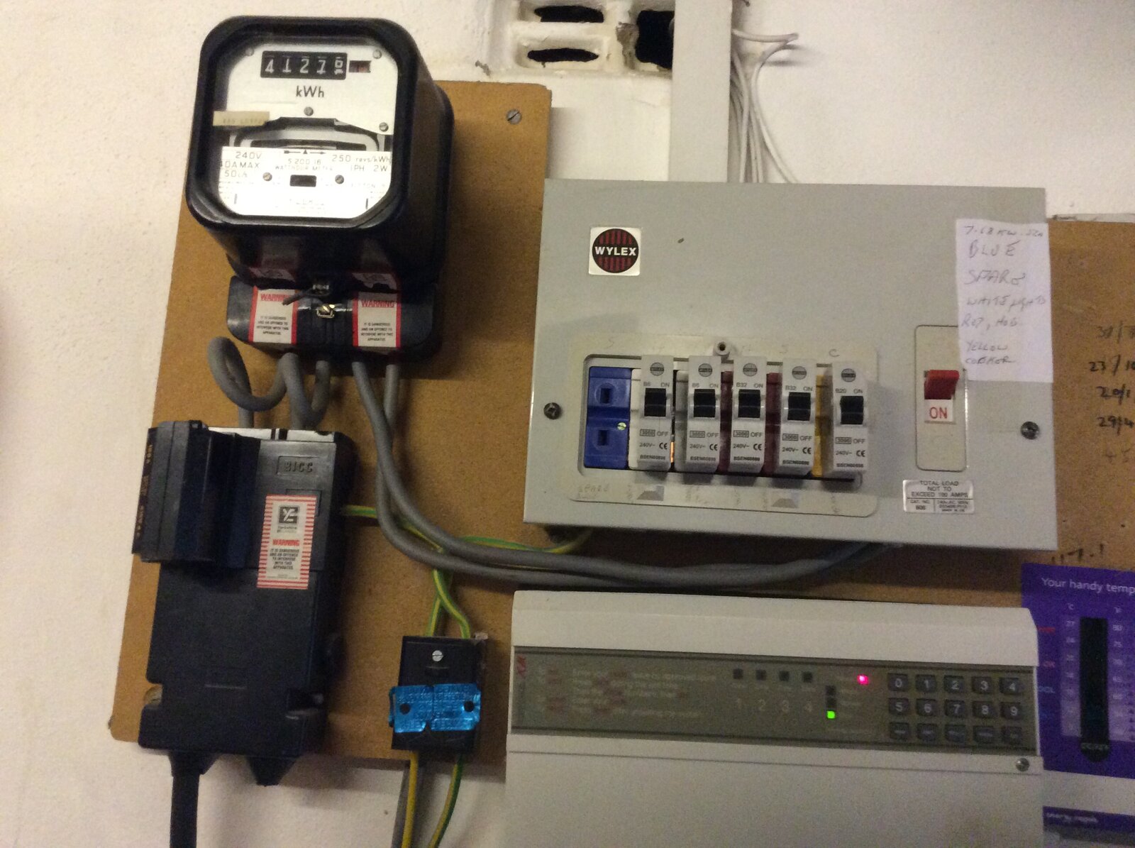

Hi Guys, in need of some advice please.
Bare with me, I am no electrician.
Been in house 26 years, it was rewired before I moved in.
I bought it of an electrician.
Beginning of this year, had new kitchen installed, the electrician was needed to instal 6 ceiling lights, and new appliances.
The CU had not any rcd’s, only fuses, so he advised I replace with rcd’s .
There was/is no rcb for whole house, is it rcd or rcbo ?
I said it would be just as cheap replacing the CU, which has it in ?
He said, to do that, he would have to spend a lot of time checking all switches, plugs etc, to issue a certificate, and didn’t seem keen !
He recommended putting a rcbo between the meter and CU, which he had, and could issue a cert, for his work,so I agreed, wanted the cert.
Cut a long story short, when he had done all the wiring, he tried installing rcbo,”But, he said the ring main and light circuit were tripping, but, the new rcd’s in CU were not.
Some thing earthing probably.?
Never unplugged any devices, to see if it was any of them, just took rcbo out again.
He didn’t show me it tripping !
Out come, no cert.
I asked if he wanted to find the faults,to issue the cert, and give me peace of Mind I was up to date, I know a cert is required if I should sell the house ?
He didn’t really want to, busy, he does offices, and only houses, occasionally, as a favour to kitchen fitter.
He said it could take days, and still not find the faults.
I have mice all the time, could have chewed cable, anything could be at fault ?
Covid hit!kitchen finished just in time.
So, no workmen.
Payed I’m off.
Wife shielded, still is.
I would like the faults found and a cert, at some stage.
How difficult is it to find the said faults.
I would like some advice, whether to ask him back to do work or get someone else ?
I am happy with his work.
Is an rcbo outside of CU ok to issue a cert.?
One relies on what the professsionals tell them, I went with his.
Sorry it’s so long.
All electrics are ok, and always were.
Just not up to date.
Appreciate any advice in advance.

Post a picture of the CU and anything else that has been fitted.
Just copy and paste or drag pictures.

It can be quite difficult to track down earth leakage faults, which means that the time, and therefore the cost, cannot be determined in advance. Rodent damage to cables is a common cause.
The consumer unit you show is rather an old type and not suitable for RCBOs.
Putting a single RCD in the supply to the CU is a very bad idea because as you have found, it is quite likely to trip, and will turn off everything in the house.
It would have been possible to add a new CU and connect just your new lighting circuit to it, and issue a certificate just for that lighting circuit. That might be your simplest and cheapest option. Sometimes people do that, adding quite a large one so that the remaining circuits can be transferred into it when time and funds permit.
But I have a feeling that the electrician you used is either inexperienced, or unwilling to solve your problem, so maybe ask around for personal recommendations from people you know and trust.
Online paid-for advertising companies, masquerading as recommendation sites, are not a good source.
(an RCBO protects a single circuit, and provides both overload/short-circuit protrectn, and earth leakage protection. RCD is a broad term, but in your case would mean a single device that provides earth leakage protection only, to one or more circuits which have their own overload/short circuit protection in the form of individual fuses or miniature circuit breakers).
In your existing consumer unit, the individual breakers on each circuit are MCBs. These are used instead of fuses. They offer no RCD protection.
Sometimes an MCB can be replaced with an RCBO, which offers overcurrent AND RCD protection.
Unfortunately RCBOs will not fit your CU.
The RCD that apparently was to be fitted between your meter and CU is called an RCD or more specifically an RCCB.
The trouble with this arrangement is that one faulty circuit would cause total power loss, which is inconvenient.
If a faulty socket circuit causes an RCD to trip, the obvious thing to do is to unplug every appliance, and then see if the RCD re-sets.

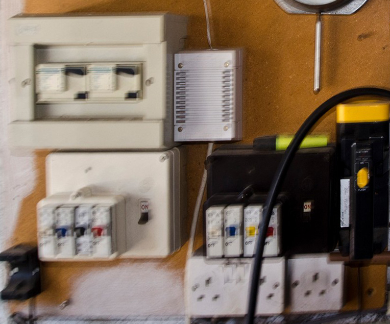

get a different domestic elec. in to fit you an all RCBO board (£700 ish) or do an EICR in advance (£125) to look for faults
They are very busy ATM
Fuse-box.jpg You can fit RCD protection as I have done here. But that was done around 1992 when consumer units with it all built in were not around. And it has cost me around three freezers full of food when it has tripped while away.
My son has every intention of replacing it with a modern unit. This house I decided the extra £100 to have all RCBO's was worth it, specially as I need to go outside to reset anything. Tripping is such a random thing, as said I have had RCD protection for nearly 30 years, and I could go 18 months or 2 years without a trip, then trip twice a week for a month and then another 2 years without a trip and never did find anything wrong.
Here I have had it trip once, good reason, roof leaked and water got in a socket, but that was one circuit of 14, and I could manage without it. So RCBO may put a £150 pound extra on price but well worth it.
