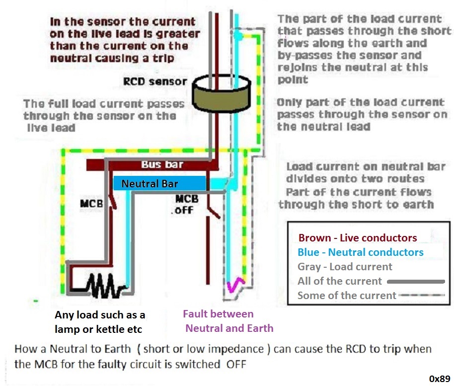

Does a rccb or rcbo detect earth leakage or fault and trip if circuit is not live ?
E.g. bedroom lights switched off at switch .
They never detect earth leakage. They detect imbalance between live and neutral. Obviously if the circuit is not live there is no imbalance.
They do detect earth leakage current by measuring the residual current (imbalance) of the line and neutral.
Yes, with a neutral-earth fault on one circuit, an RCD can be tripped by current from another circuit (covered by the same RCD).
They do not detect earth leakage, they detect an imbalance. They often do not even have an earth connection to them. One reason for an imbalance is earth leakage, there are others such using a borrowed neutral.
No, they measure residual current and respond.
One cause of this is current leakage to earth - therefore they detect it.

When my electrician put the rccb/rcbo, I do not know which I tried to use, he said both light circuits a ring main we’re tripping as soon as he turned the power back on at the CU, so just took it out immediately ?
As there were no lights on in the house, he was on a step ladder with his headlamp on, by the CU,how would the light circuit trip.
As you both say, no lights on, no imbalance ?
I know that part of the lighting circuit must be live, but it is certainly limited.
The only things on in ring main were freezer and new fridge he wired .
Why did he not just unplug everything to eliminate electrical items before taking rccb out ?
He said it could be “earth leakage”, or anything, and could take ages to find.
Fair enough, but as nowt was on
It certainly reduces the places the “said” fault’s could be ?
