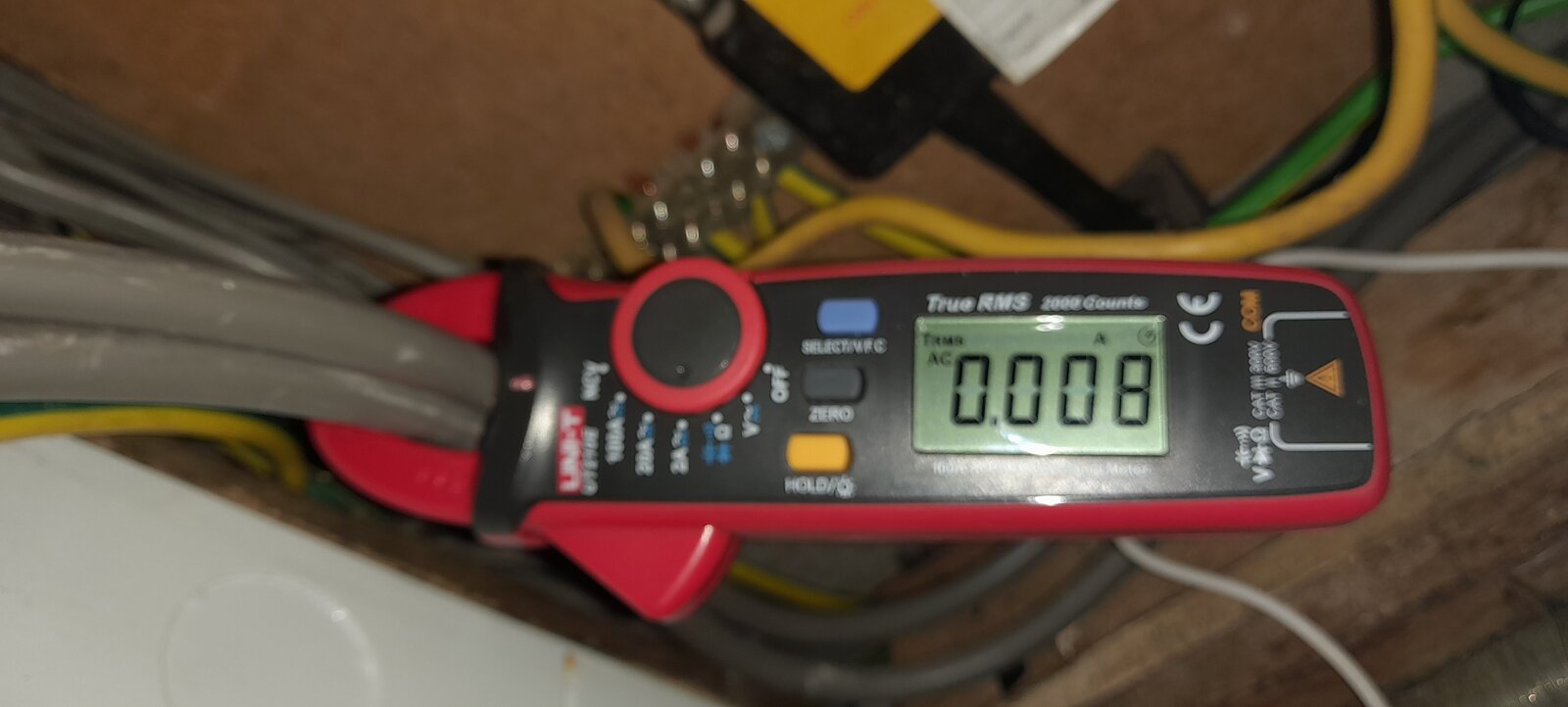

The central heating did run on a RCBO until solar panels fitted, no problems, when solar panels fitted it was transferred to a UPS supply, so no longer fed through the RCBO, so I fitted a RCD FCU, but when CH started it tripped, so put old FCU back, thought summer is time to fiddle, not winter.
So out of interest measured the current through the earth cable, and no where near 15 mA, there is some current around 5 mA, but not enough to trip a RCD.
Same measuring meter tails, earth leakage is well within limits. Not used an insulation tester yet, that's a summer job, but it does seem something to do with using a RCD FCU instead of a RCBO.
I could not get a type A RCD FCU from City Electricial factors, so wonder if just unlucky, my RCD tested died, so can't test the RCD without borrowing one from work, have considered setting up a test so can simple plug in to test and take it to work to test, here no socket outlets without RCD protection. There are at work.
But does seem like a faulty RCD FCU. But wondered if anyone else has had problems with RCD FCUs as to date found very few faulty RCD's

I did Diffrence line neutral 8 Feb 24.jpg and 8 mA is not enough to trip a 30 mA trip, I could not reach the two lives at the FCU, that is the leakage to whole of the solar panel system and inverter.
I wanted some pictures of using the clamp on, and has not intended to look at the central heating, I had decided last year to wait until will did not need heating before investigating further, after all it all complies as it is, and I have a compliance certificate to prove it. However it niggles me to have the central heating as the only item in the house not RCD protected.

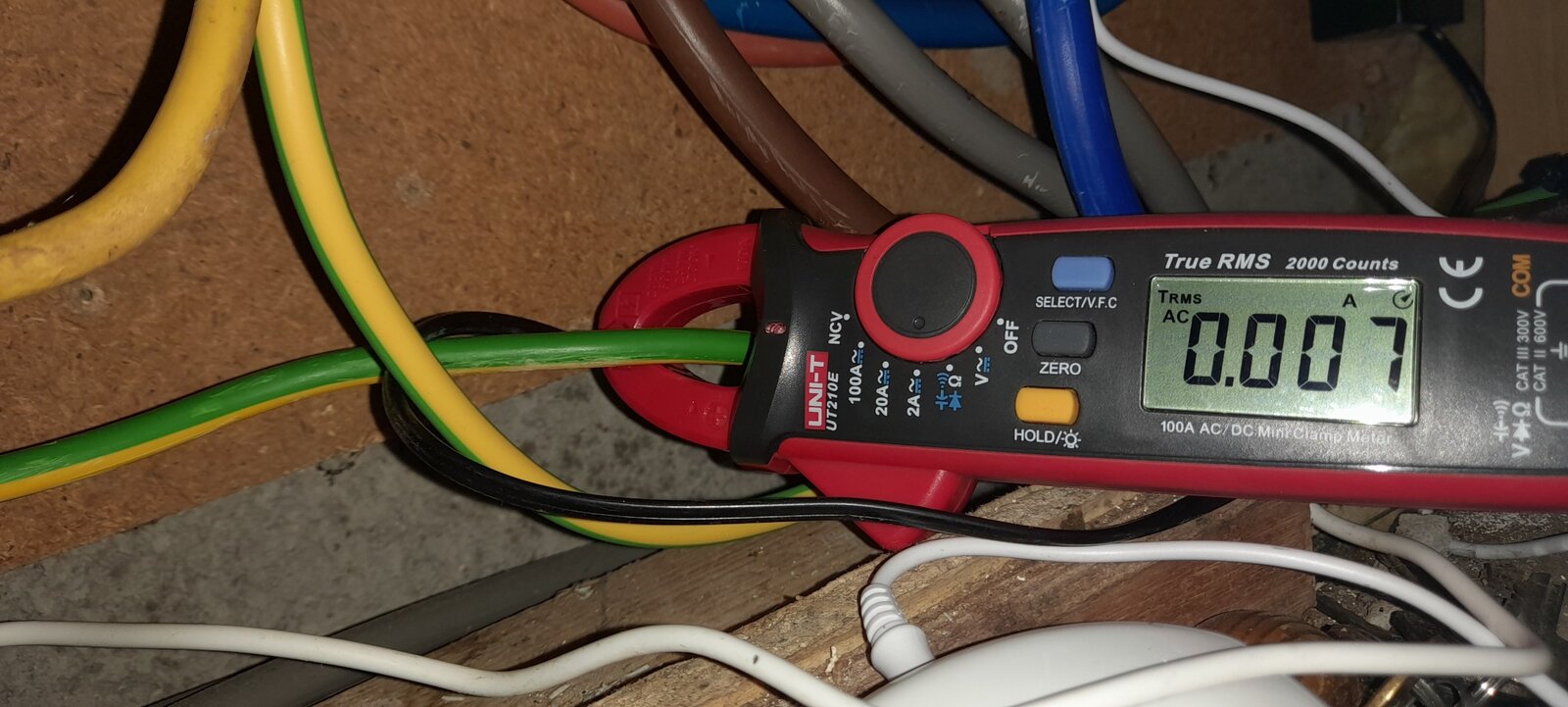

I did note a leakage to the earth rod Leakage to inverter 8 Feb 24.jpg and I was wondering if over time it could cause erosion, but 7 and 8 mA is really nothing, I had expected to find the inverter had a much higher leakage and that there was a fault with the central heating some where which was causing the RCD to trip.
I want to add a second thermostat, and thought it would be good to cure the leakage problem first, but can't really cure a problem which is not there.
