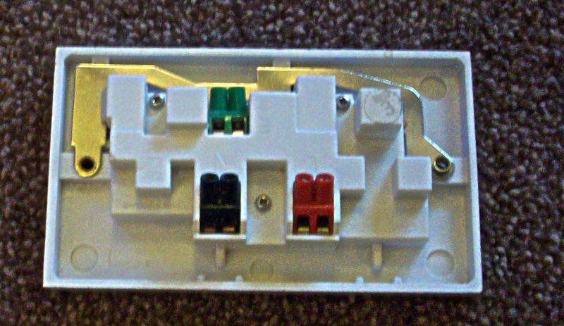

[(even though I've never really understood how people can be so daft as to do that!).
Thoug not domestic, have you experienced fitting ELECTRAC sockets
No, I haven't (my experience of things non-domestic is next to zero). However, I have very occasionally come across sockets such as EFLI described, with the earth terminal within the plastic moulding, hence not looking much different from the other two. I've also dealt with ones like this:
... in which, if one doesn't understand colours, the earth terminals look much the same as the others.
Kind Regards, John
Do you know what brand that socket is john?
I have some in my cellar which I took out of service (simply because they were no longer required, during some rebuilding) several years ago. The only marking they bear is "RPP" (as well as "PROV PAT" and "Made in England"), if that means anything to anyone. They bear no reference to BS1363 (or any other Standard), but they appear to have standard shutters.
I have no idea as to whether any similar items are still available - I certainly haven't seen any. Although I realise that there are 'pros and cons', I personally very much liked the idea of paired terminals (i.e. just 'one conductor per terminal' in simple parts of a ring or radial circuit).
Kind Regards, John
They are RPP brand. Redditch plastic products. It's one of city electrical factors' own brands. Think they have now been replaced by the M2 brand which still have the same style terminals.
Thanks - that would explain why they are marked "RPP" :) I must say that I'd never heard of that brand.
That's interesting. What do you think of that style of terminals?
Kind Regards, John
Personally I don't like them especially if you have 3 cables at one socket.
