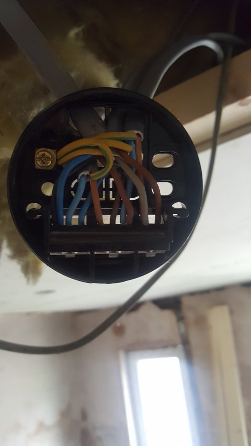

As discussed, this morning I disconnected half the upstairs lighting ring. Switched on the mcb and checked to see which lights were working. The bathroom and landing light both came on which just left 2 bedrooms which did not. This did trigger a thought which is an extractor fan in the bathroom wired to the light but I thought I will just leave it and see what happens. Within 30 minutes the RCD tripped. I opened up the extractor fan and removed all 3 wires (live, switched live and neural) It is a new extractor so less likely to be a fault with the unit I would have thought. I switched the mcb on again to check it wasnt the wiring to the extractor. Again within 30 minutes the RCD tripped. I went to the cu and removed that half ring and put the other half in. So far, nothing has tripped.
Confession time. I cant get the extractor out of my head. I fitted it and wired it. I will try and put a picture of the rose wiring below..... one minute.... ok, that took longer than a minute and the picture is huge.
I wired the rose in the normal way then for the fan I I used some 3 core & earth. I wired brown to loop, blue to neutral and grey to switched live. The fan instructions said its double insulated so doesnt need an earth so I put the earth in the rose as usual and cut the earth off at the fan end. I am almost certain this will be the problem as the rose is in the ceiling with no access from above and I am was about to plaster the ceiling....
What do you think?
That sounds alright.
Naughty. Never cut unused cores; they may be needed one day.
Not sure what you mean - but:
If you are satisfied this is where the fault is:
Disconnect at the fan terminals, reconnect the light ring,
if it trips disconnect the fan cable at the rose and replace it,
if it doesn't trip replace the fan.

If I understand the above correctly, you appear to have eliminated the extractor itself as the source of the problem, since the RCD still trips when the extractor is totally disconnected. However, your finger still seems to be pointing at the half of the lighting ring which feeds the extractor.
Is there anything else connected to this 'half ring'. For example, are there any dimmer switches or suchlike involved?

What I meant EFLImpudence is its just my luck for the fault to be in the bathroom as its the only wiring I cant access without taking the ceiling down.
I did eliminate the extractor John by removing the wires completely from the extractor and the RCD still tripped. The image of the rose was one I took from before I put the ceiling up. I did this as a reference in case I needed it later on. The rose is now in the ceiling.
The only things on the disconnected half of the circuit are the bathroom light and extractor with a bathroom pull switch and a landing light with a twin switch. The twin switch will turn the upstairs and downstairs landing lights on and both can also be turned on and off from downstairs.
