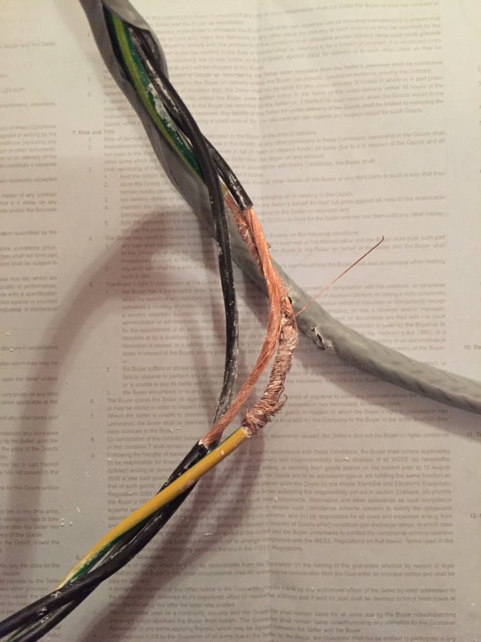

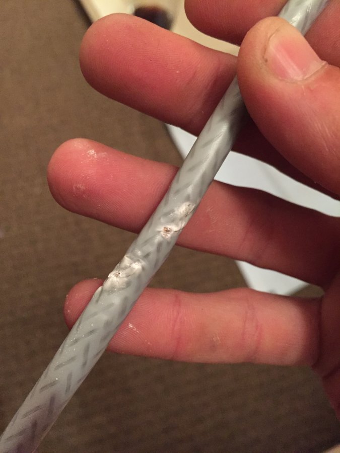

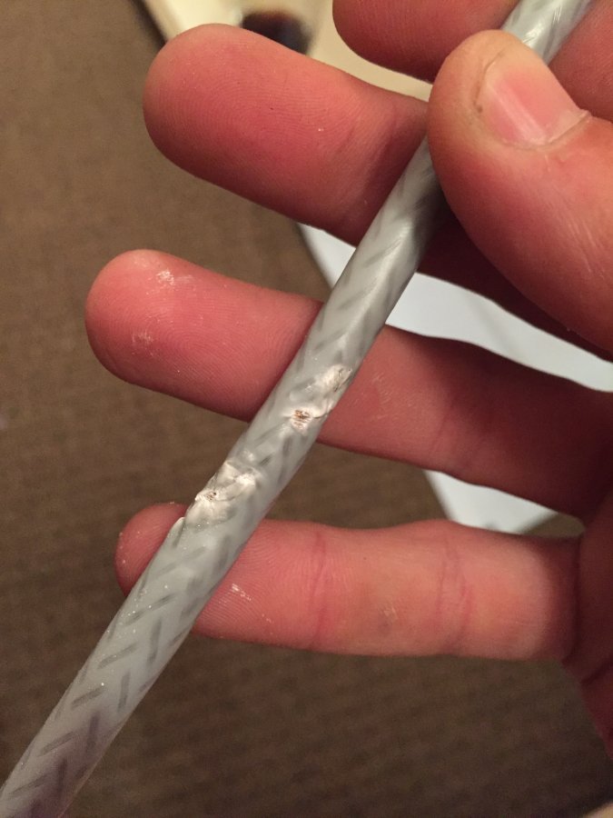

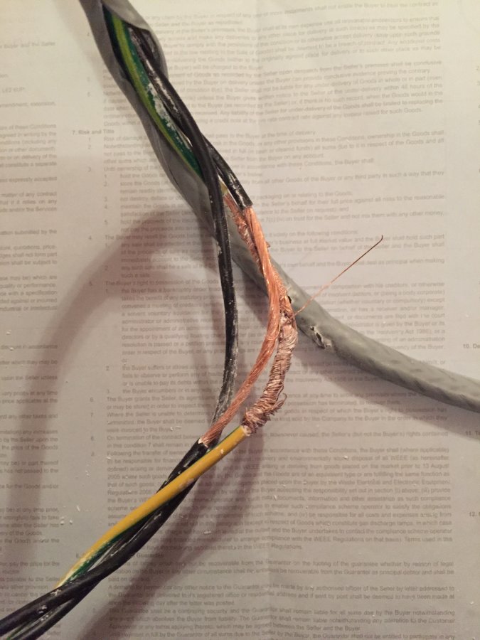

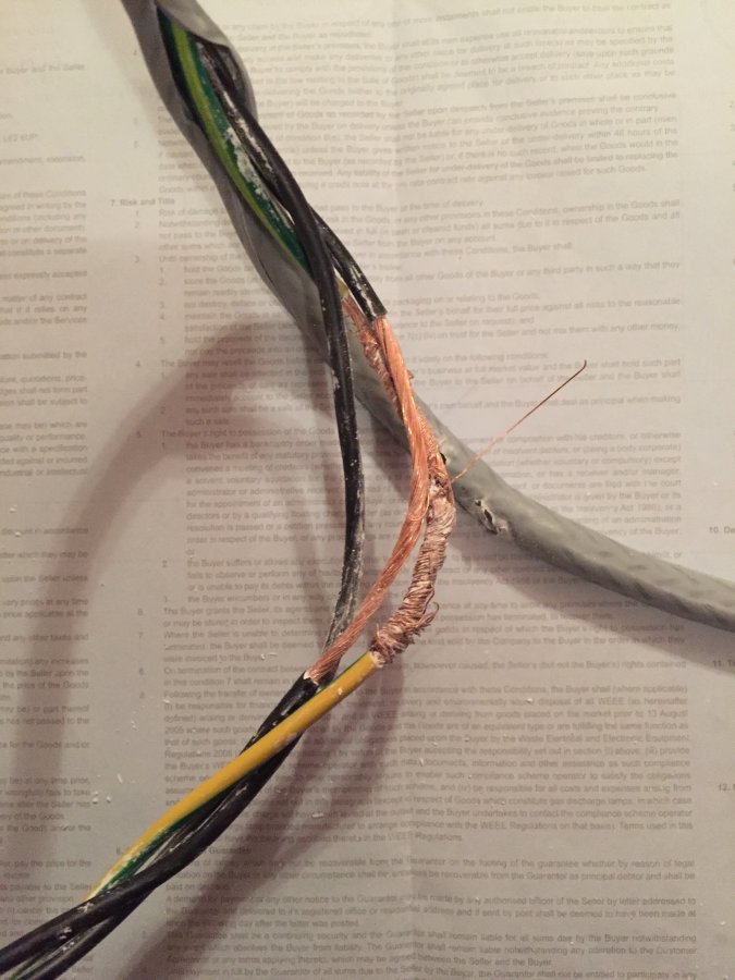

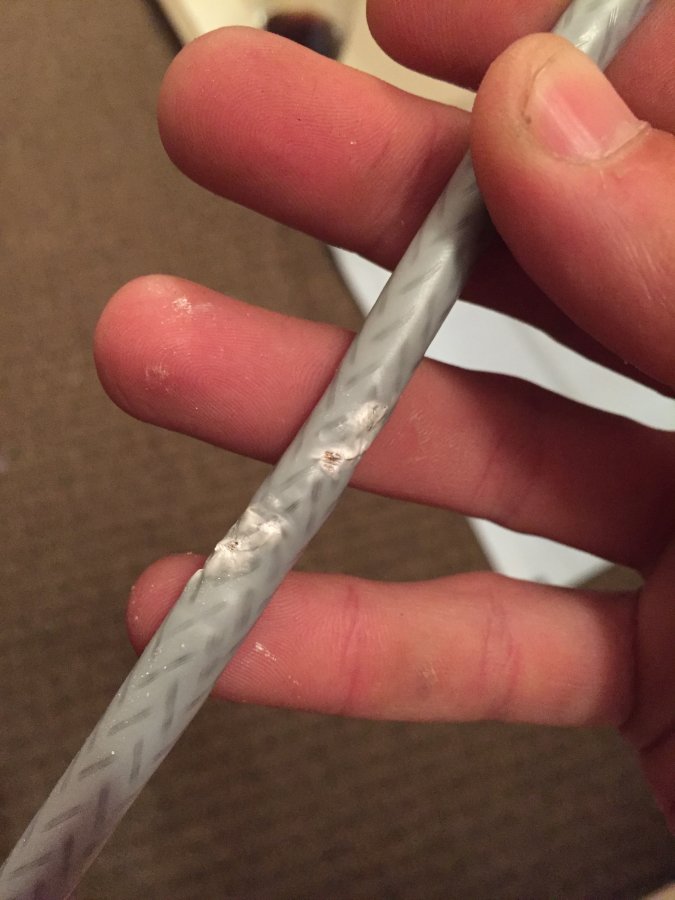

I had a 5-metre length of T & E feeding a security light, installed by a pro while I was travelling for work, which had three L - E shorts in it. It was Turkish. Faults showed up after a few months' use. It was in the loft, not subject to any movement, and only supplied the 150W light.
As you can probably tell from the first picture, it was from a drum of SY.
The only visible sign through the clear layer was a TINY amount of talc. Not even really sure how it could have happened. The machine they use to extrude the cable must have jammed a bit. Friday afternoon perhaps?
