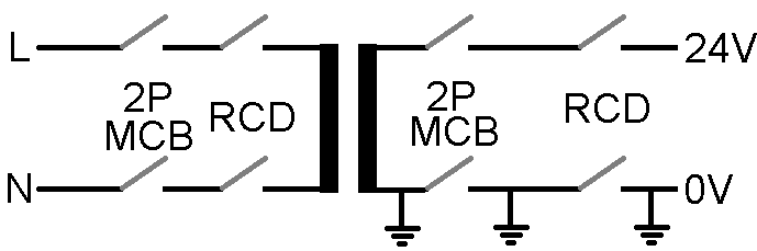

Even now we have specs for control panels which still state 2P MCB mechanically linked to RCD, these consultants really do not listen.
I've lost count of the number of times I've constructed panels with a control voltage (typically 24V) transformer with 2 such combinations around the transformer. I've shown the earth in 3 different locations as different consultants/designers have different ideas but of course only one would be used:
So 8 modules of DIN rail space when 2 will do and a lot cheaper. and often for a transformer of only 25VA although the same arrangent would also be used up into KVA sizes.
Albeit this if veering well away from DIY again.
Even now we have specs for control panels which still state 2P MCB mechanically linked to RCD, these consultants really do not listen. ... I've lost count of the number of times I've constructed panels with a control voltage (typically 24V) transformer with 2 such combinations around the transformer.
I somewhat struggle to understand how there could ever be need or justifivation for an RCD (whether or not mechanically linked to an MCB) in a 24V system. Am I missing something?
Hmmm if the only earth used was the right-most one you show, the RCD could never operate, could it (because the 'supply' is not earth--referenced)?
