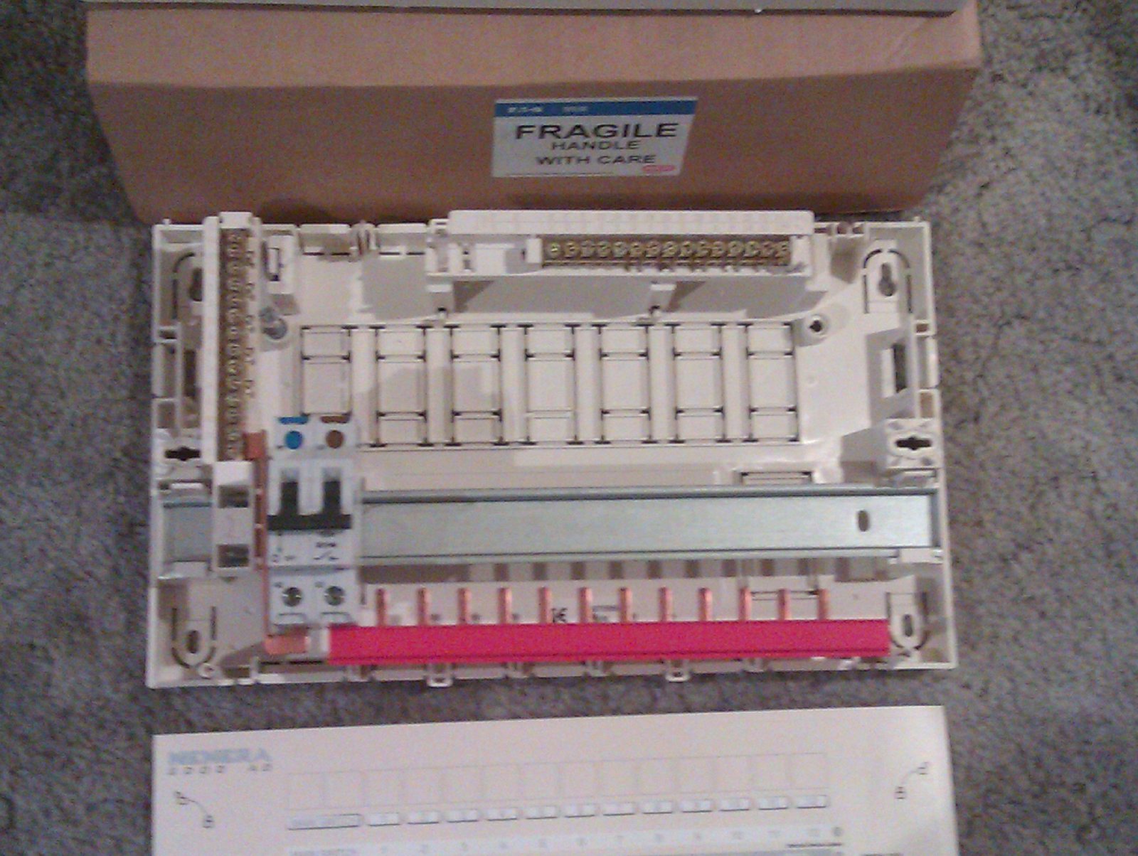

here's an ordinary one. It has only one busbar and only one neutral block so could not be used with two RCDs.

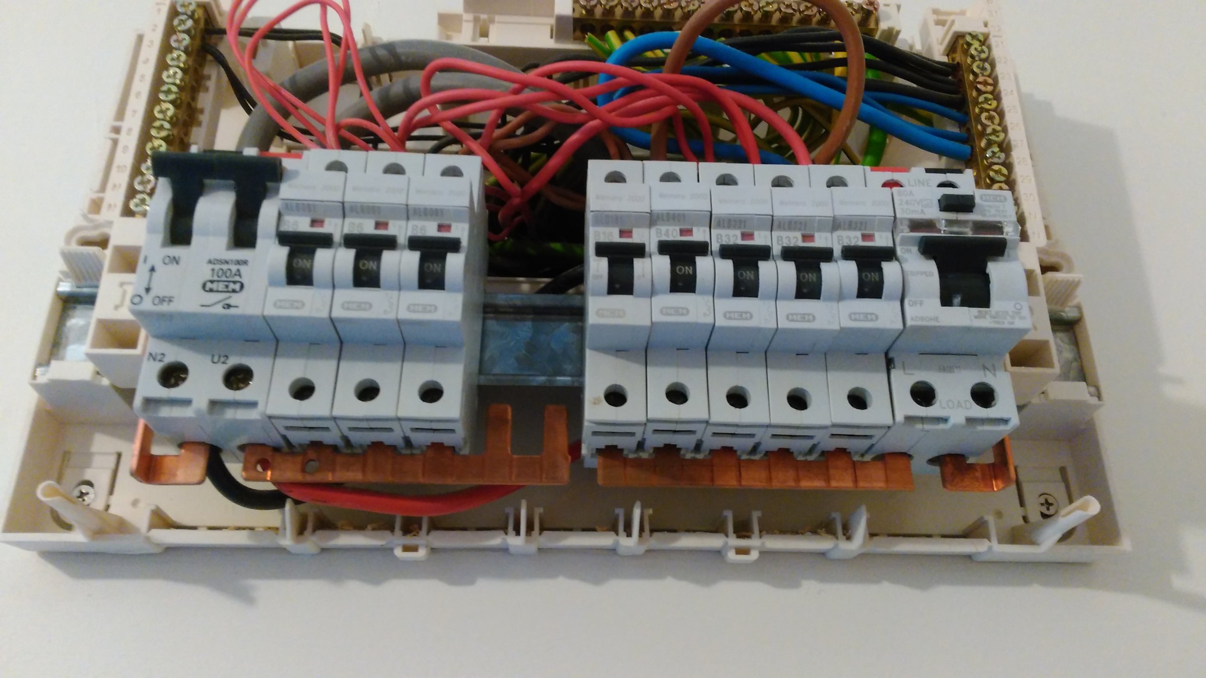

heres a (larger) one intended for two RCDs. It has a main switch, can supply two RCDs (only one is fitted in the pic so far) and it has two busbars, two earth blocks and two neutral blocks. It would also have been capable of supplying one set of RCD protected MCBs, and one set not RCD protected.
The last time I looked into it I was told that parts for Memera 2000 boards were no longer manufactured and therefore you were talking serious money to get parts for them.
Memshield 2 devices fit them, and are still sold by the million because they are so popular in industrial and commercial installations. You can even buy used ones at low prices...
The ones in my pic have black print and the red/green indicator window. Some older devices have red print and no window.
IIRC they have a 10kA fault break, which is greater than the Memera2000AD. Not sure what the Memera 2000 is. Memera2000AD has smaller "teeth" on the busbar and a smaller aperture in the breaker so cannot be used in Memshield 2; but Memshield 2 devices can be used in Memera2000AD. I presume AD were cheaper. I have an idea they don't accept RCBO Pods.
indeed, though they may be safer than certain brand-new imports.
They are often stripped out of industrial boards, but sometimes from unused maintenance stock.
Many thanks for the excellent answers and helpful photos. Please see the photo of my existing consumer unit. It seems to only have one busbar, so I can conclude that fitting 2 RCD's is impossible on this board? However it has been cut in 3 places, so it is in 4 pieces.
It does actually have two busbars and two neutral blocks, so the RCD side is separate from the non-RCD side. But it would take some tinkering and fabrication to modify it into two RCDs, as the existing connectors would not fit, and it would no longer meet the type-testing.
Adding RCBOs is a better solution, and very simple.

Just some more background to my case (not the original poster), the reason for suggesting adding a RCD was to protect some existing lights and extraction fans in bath and shower-rooms around the house. I'm quite sure that these lights and fans were fitted when the house was built around the year 2000. The fans all have isolators. I have since replaced 2 of the fans, but the wiring etc. has remained unchanged. Currently the electrician is suggesting replacing the 3 unprotected mcb's with 3 RCBO's. But I was wondering about adding a RCD instead. Hence my recent post.
Thanks for the clear answer. So I understand that adding another RCD is possible, but not the best solution. Many thanks. I wasn't expecting such fast and good answers to this old thread! :)
