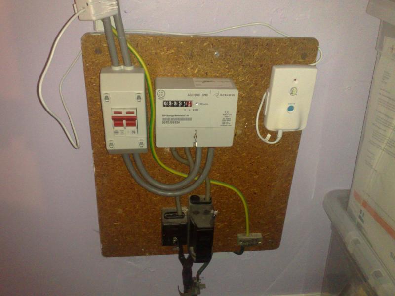

Hi All,
I have an RCD that keeps tripping randomly - Maybe 2/3 times a day.
I have done all the usual and unplug everything - it still trips.
I thought I would get a earth leakage meter, I'm having trouble understanding the results (I have noticed that if I turn the unit the other way on the same pair of wires it tends to half the result).
Taking a reading on the main pair - if I turn a certain 32A breaker off the reading drops a lots compare to the other breakers. I'm guess it's something on that line causing the trouble?
I don't get why that earth cables reads 2.5A (not 2.5mA). Is this normal?

Where did you get 2.5mA from? If you are getting a reading of 2.5A then 2.5A is flowing. An insulation resistance tester would be far more useful to look for tripping RCD faults. It is possible that several amps my be flowing through main bonding conductors, though I've only noticed this once. What reading are you getting from the upper earth conductor?

Do not measure the earth conductors. Measure around Line and Neutral.
Judging by the pics, the OP has done both - albeit I'm not sure what earth conductor he is measuring (there are two coming from cutout) - so, as freddo has said, may include bonding currents.
If (as in my house) the bonded water service had a low impedance to earth, it would require less than 1V between the PME neutral/earth and true earth to result in a current of 2.5A in the bonding conductor.
Kind Regards, John
Yes, but the current on the earth conductor(s) is irrelevant.
OP shows 123mA and 55mA leakage on tails so now needs to test (or completely disconnect) individual circuits.

Thank you for the reply freddo - I was alarmed by what I thought to be a high reading for earth conductor. (I thought theoretically you only see a current on the earth conductor if there is a fault). I tried a similar thing next door and it read 16mA. So a reading of 2.5A could be fine in some cases?

Thanks for the reply John - yes I have done both but was puzzled by the results. Thanks for the explanation which I will try absorb later.
The readings of "leakage" on the red and black tails should be the same as the reading on the grey tails ( there is no earth to the meter so no earth leakage in the meter ).
The difference 55 and 123 is probably due to the positions of the cables in the ring of the sensor and / or dirt on the face of the gap in the sensor ring core preventing it from closing properly.
As already mentioned the only reliable way to find the earth leakage route(s) is by insulation impedance measurements on both Live and Neutral of each individual circuit. The neutral must be disconnected from the Neutral bar in the CU to allow the Neutral's insulations to be measured.

Thanks for the reply - again I was puzzled by the different reading, even with my limited knowledge I thought they should be the same - but the meter is new and I don't think there was a gap. I have tested several times and I still get a big difference between the 2 sets of tails.

A gap of 0.1 of a mm will affect the accuracy of the measurement so a bit of grit in the gap will affect the reading. Also the two wires being compared for difference need to be as close together and in the centre of the sensor core if the results are to be anywhere near accurate for the difference in current. The reading for a wire touching the sensor core will be slightly higher than the same wire and current when in the centre of the core. The grey wires ( straight ) are a half turn in the core while the red and black ( U shaped ) are more than a half turn so will give a higher reading than if they were straight.
