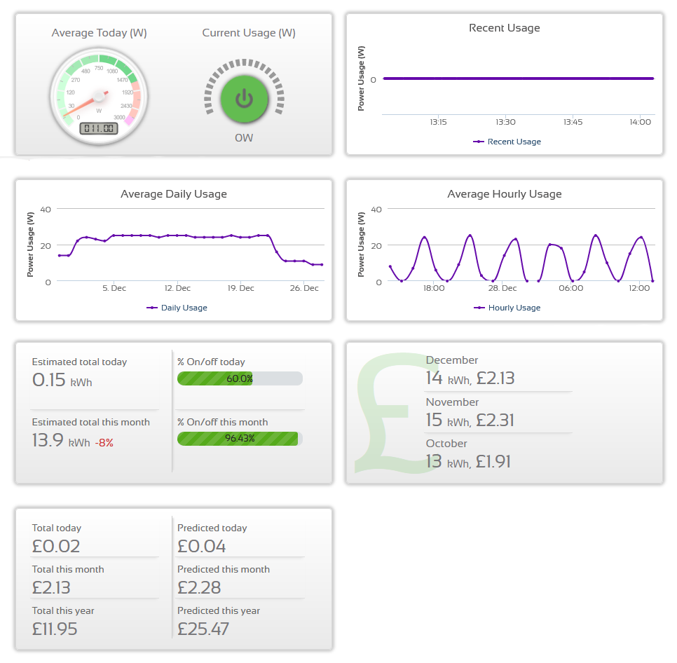

I now use three plug in devices, the internet connected ones Energenie give me this 1672236571457.pngnot bad, but the non internet also gives power factor etc.
The one giving all was rather useless, to check one item, you need nothing else switched on, it did as designed it told Scottish power what to charge me, but it was to me no better than a toy, in fact the plug in ones are really toys, the one shown is monitoring what power my beer brewing is using, if it is switching on/off then beer warm enough, if not then beer under temperature. I have also used them to monitor my smart chargers, and check the freezers using the power it should use.

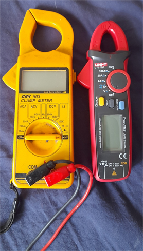

My clamp on meters will show current flowing Clamp-meter-small.jpg but they do not record time, so I can put it around the tails, and see by turning off all the RCBO's then turning them on one at a time what each circuit is using, but what does that tell me?

I remember fitting data loggers to tower cranes, as the client had site cameras which seemed to show cranes not being used, here looking at the time between samples, one frame every 10 minutes was missing crane being used, and the same goes for any data logger, look at the graph of date used that I have posted in last post, and clearly the heating pad switched on/off, so should be straight line graph, but it shows a slope.

So why you want to measure is rather important, I have never repaired the old Scottish power energy meter, the battery box has corroded, but in the main my clamp on meters do what I need, how many mA flowing to earth, how many mA DC flowing, what is total amps used.
