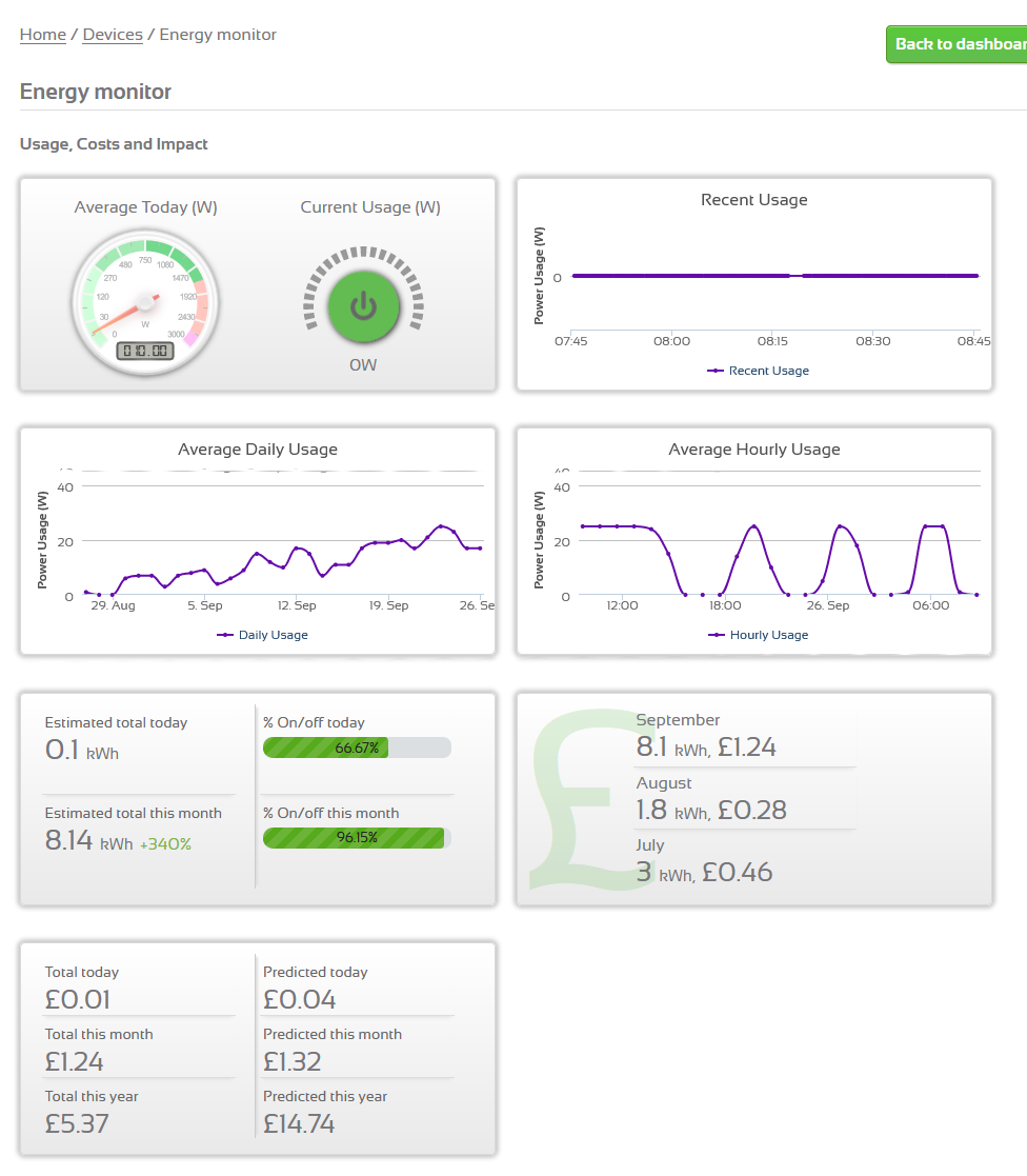

I use the Energenie MiHome because it needs a hub and I have a hub used for different things, the plug in module gives the following
To be frank there is more information given on the non PC connected version, in the main I use to monitor when some thing has completed, battery charge etc. I do check freezers to see how long they run for, see if insulation has failed, but once the first month or some had gone, they were really no more than toys.
