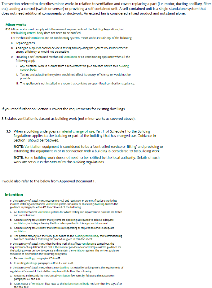

@22:20 (22 minutes, 20 seconds) in, the Envirovent technical services manager suggests that replacing a fan in Mrs Jones house would be notifiable work; you need to be a competent person to do that; and you need to do the course and register with the scheme. A little later he then talks about new builds, and sign off by BC.
The conflation of the notifiable new build work/ventilation work as part of a refurb, with the non-notifiable minor works, has caused all this fuss.
Due to the way homes are sealed up, without proper extract fans, the homes quickly suffer mould growth. So - essential fitments, for most modern homes.

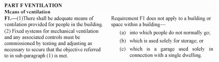

If they build air-tight houses but Part F says buildings must be adequately ventilated something is not right.

I emailed eFixx and their response was great.
They forwarded the email to EnviroVent, and here is the reply...

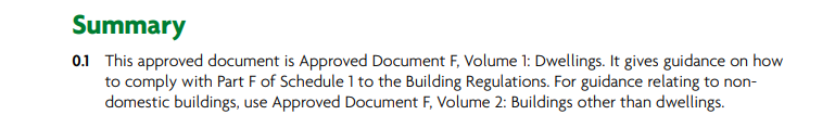

So, the arguments seem to come down to definitions - i.e. fixed products and standalone systems, that don't seem to be defined within the document.
They are happy for you to replace the motor, ducting, etc. individually, in the extractor fan, but not the whole appliance. Trigger's broom comes to mind.
Correct me if I'm wrong - I'm not - extractor fans are not compulsory.
The 'Guidance' suggests it...
They appear to still be committed to a like-for-like extractor fan replacement being notifiable work.

Like Part P, Part F is very short:
So, is building an air-tight building contrary to Part F(1) unless it comes with an adequate mechanical system specified by the architect?
If so, why do electricians have to be trained in something not electrical? Oh yes, £420.00.
