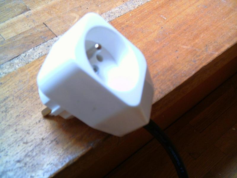

Not sure if name & shame is OK on this board but I bought a french bit of kit for rainwater management:
http://www.pompesguinard-batiment.f...cat=recuperation-eau-pluie&produit=Eco-System
Manuals are on that page in 3 Euro languages.
From a UK disty:
http://www.directpumpsandtanks.co.uk/
and it came as if I were a frog in France.
I have at least one big "legal" problem with this as there are two Type E plugs one for the pump and one for the 3 way valve (mains or rain > output) and that one has to be plugged into a "socket" which is attached to the float switch which switches the live on/off.
The "socket" passes neutral straight through to the pump and switches live on /off via the sealed float switch which is a lump of metal in a sealed float which makes or breaks the live.
Simply replacing the type E on the pump is OK providing you make sure that the 4500 motor isn't using 16A and is OK on UK 13A, but the system won't work if you either plug the valve directly to mains (permanent on) or if you put a UK plug on the float switch (bang when the float is short) on the basis that I have never come across a UK equivalent of this live switching Type E socket adapter which is on the float switch.
I don't see how jpandt should sell this kit in this way, I think they should do a conversion in some way to be compliant with our regs.
Opinion?

the floatswitch plug/socket is shown 2 posts above yours..
it plugs into the wall and the pump plugs into it..
the float switch then switches on the pump as it needs to..
So the white block has a cable coming out of it?
If it was mine, I would simply chop the lot off and start again but I dont recommend that if your not 101% confident with how to do it. Especially as its foreign and the wire colours may not be as expected.
