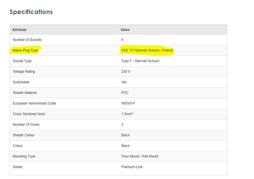

Ok, you have found a rather specialised looking item that has individual (dp) switches.
Unless you find any with ordinary looking single pole switches, like UK ones, then your fears are groundless.
I was just showing that one can get individually switched Schuko trailing sockets, not that I was suggesting the switches were single pole. (Although I am sure if you buy from less than reputable online sources you could end up with single pole switches and other compliance issues.)
Ok, but that was not your original query so I'm not sure what you are getting at.
Apparently there are some specialist extension leads with switches.
My statement was too sweeping but none of the ones I have for the usual things do have switches.
Unless you can find some with single pole switches then your original concerns are groundless.
