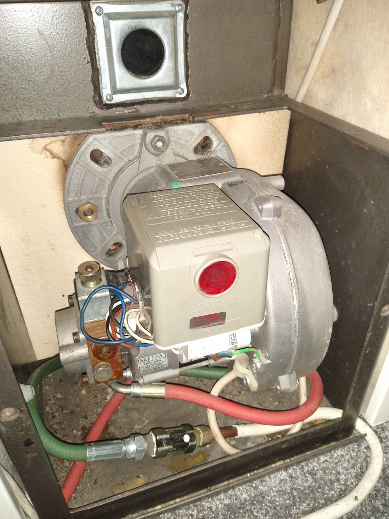

I recently moved to a property with an ancient Firebird Olympic 50-82.
It's developed a fault where on start up the fan motor runs continuously but the burner will not proceed to ignition. It will stay in this condition until you turn it off and it does not enter lock out - the fan just keeps going and going...

On inspection of the burner, I'm pretty sure he hasn't changed the solenoid as it was quite grubby - unless he substituted it for a second hand unit. Whether the fault could be related to this part change (or not) I don't know.
Anyway, I'm going to perform some further checks using Riello's Fault Finding Chart but if I end up having to replace the control box etc. I might consider buying a new burner unit instead.

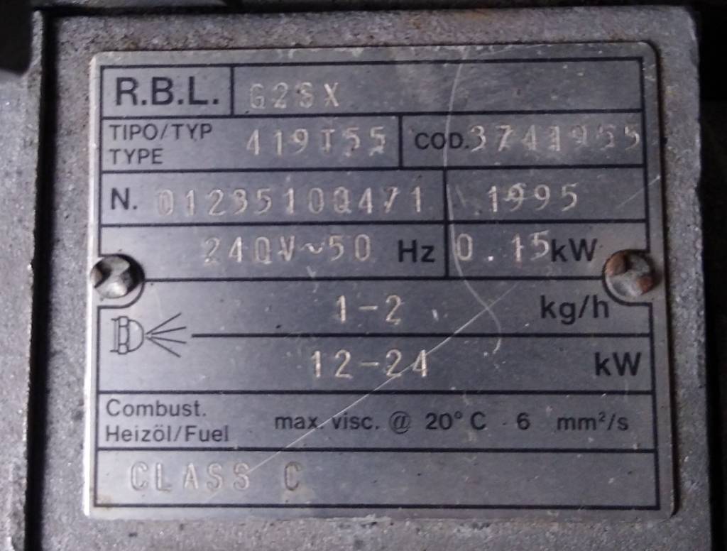

Can anyone suggest a replacement for the currently fitted Riello G2SX (419T55)?

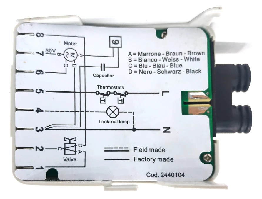

IIRC the control board provides 230V to ignition transformer after the initial purge timeout. Then if the photocell does not detect a flame before a further timeout it goes to the lockout state. It sounds as if this timer is not even starting so allowing the motor to run but I cannot think of an external reason, and you have replaced the control unit. Unless the new unit has now suffered the same failure mode as the old one from some external cause but that is rather far-fetched.
I am wondering if there is some additional control like a hidden overtemp thermostat which is inhibiting all this. Have you located a wiring diagram for your particular Riello? Mine is not exactly the same (for one thing the fan and pump are on the opposite sides). Previously I had a Potteron with Danfoss controls but it was pretty much the same.
The capacitor provides a phase shift to one of the motor windings so if it fails I think the motor will not run at all. I am guessing the motor winding has the 50V tapping to provide a convenient low voltage supply to the control board and if that is working too then the motor sounds OK.
I believe the wiring for the burner is what's printed on the card inside the bottom of the control unit.

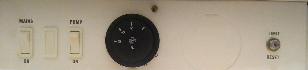

This is the very basic control panel which has a flow temperature thermostat and a resettable high temperature limit thermostat. If the latter is triggered I should see an orange neon lit, but resetting it seems to have no effect in any case.

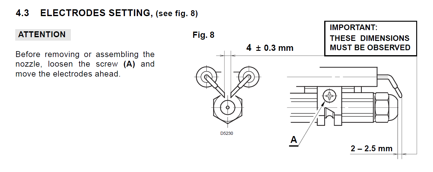

Remove the burner (ensure boiler isolated) and remove the flame tube, there are two set screws holding it on, note: there should be a drain hole on the bottom (6 oclock) ensure the flame tube is reinstalled with the drain hole at the bottom. When removed, just wipe down the porcelain electrodes with a bit of rag soaked with WD40 or whatever, check the electrode gap and positioning, should be like my Riello G5X.

Last for ever unless cracked. I use meths as it does not leave any residue. If very dirty you can use fine wire wool as well but clean away all traces. But if you can't hear the buzz it may not fix it. If you need to bend the electrodes to set the gap use a second set of pliers so you don't bend them at the insulators.
