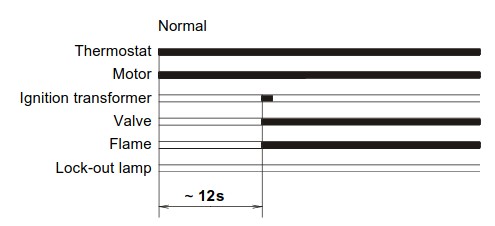

I fear cjcoffin may be right - I'm not getting that characteristic buzz from the transformer after 12 seconds, so I don't think the ignition sequence is getting as far as producing a spark.

I would try the genuine photocell, is the fan still just running and running with no lockout?, if you now remove the photocell, does it still not lockout after 12 secs?.
Yes, the fan just keeps running and never goes to lockout. Despite what Riello say in their guidance, removing the photocell and running without makes no difference and it still won't lockout.

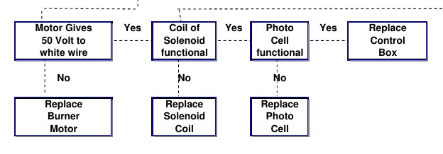

As the burner is approaching 30 years old I thought that particular test procedure may not apply, but I gather the 530SE control box was used much later than that. As far as I know it's a genuine Riello part and came sealed from a reputable source. It's very frustrating as I was hoping it would be one of the 4 electrical issues listed in their fault finding chart.

Possible I suppose but dont know what difference it makes when its removed, I think that a failed solenoid coil will also cause the same problems so maybe ensure that you have the correct one.
A very experienced guy just informed that a failed coil can cause the same problem, if so, and the new coil is OK (and maybe the old one was OK as well) wonder could it be some wiring problem as some functional test must be carried out.
The new solenoid coil was official sealed parts, but I haven't tested it with a multimeter so guess I had better do that now too.

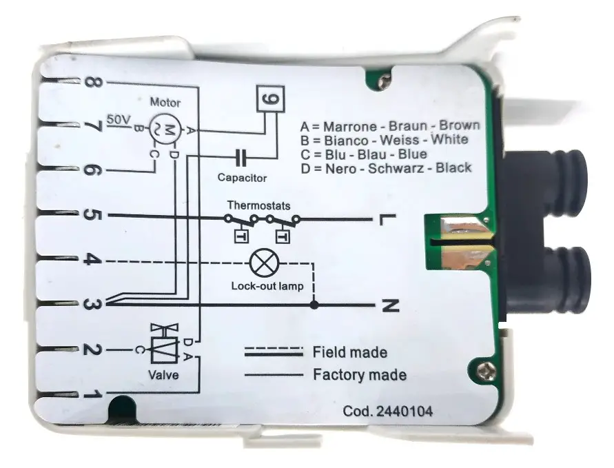

Can you do a bit of M.meter testing (with the control box removed) from the terminals shown, this should check the integrity of some of the the wiring?.
I'll run a continuity test later this week on the off chance something is wrong with the wiring.

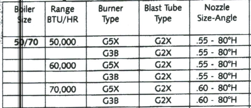

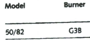

Regular 28 sec kerosene and the output range is 50-82 BTU/HR, but I have no idea what it's set up to unfortunately.
In the Firebird boiler manual the 50-82 model is listed under the "Conventional Flu Boiler House Model" section but when I refer to the start of the manual for the specifications it doesn't list this particular model. The closest which has the same burner type and blast tube combination is the 50/70.
