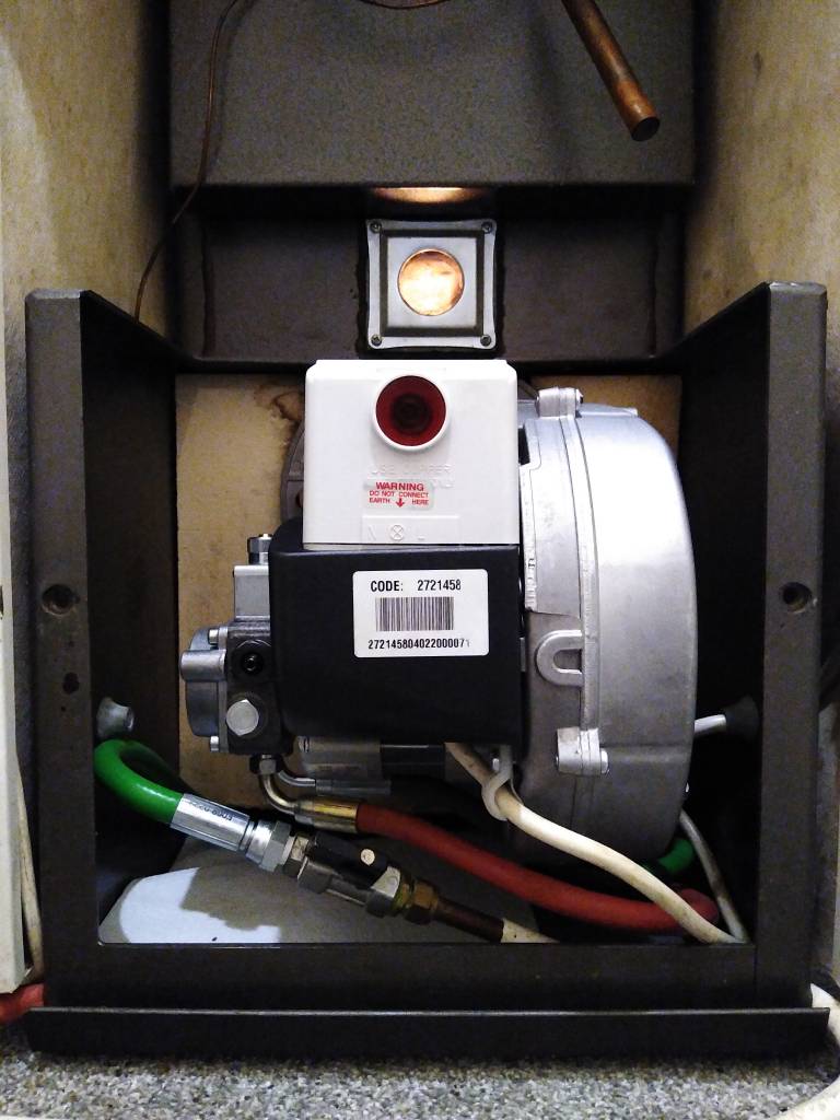

I fitted the new burner a couple of weeks ago and so far so good (y)
It was factory fitted with a 0.60 GPH 80 degrees H nozzle which is correct for my type of boiler, as was the 8 bar pump pressure and air damper adjustment setting. If I stick with this unit I'll get someone qualified in to analyse the gases and make any further adjustments necessary.
The Riello G5X appears to be identical to my old G3 with the exception that the fan unit is noticeably bigger. This means I'm no longer able to secure the metal cover which would normally close everything in. I'm not too concerned about this as the unit's in a cupboard - I might be less keen if it was in my kitchen.

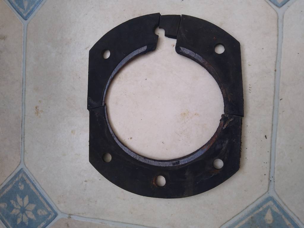

I decided to re-use the old flange as I noticed it had a slightly angled mounting face to achieve the recommended lean. It also had a better way (in my opinion) of retaining the new gasket as the edges of the flange were raised to accept it. The old gasket is what I believe to be a type of asbestos. It resembled very thick plastic, had warped in places and was no longer sealing.

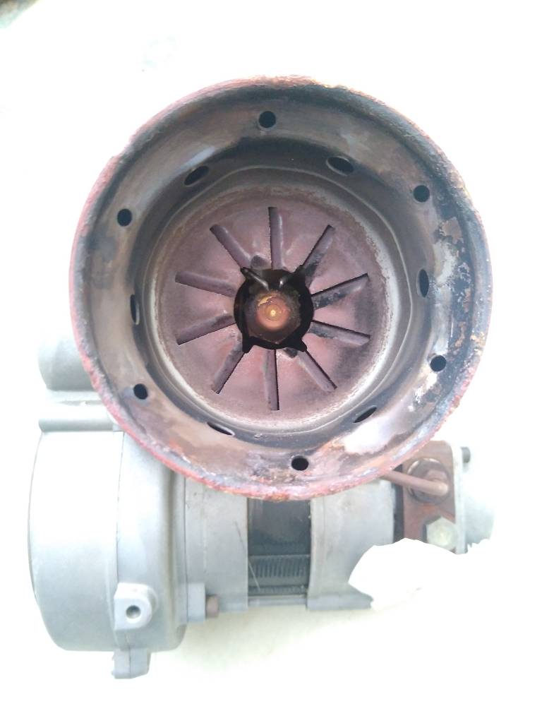

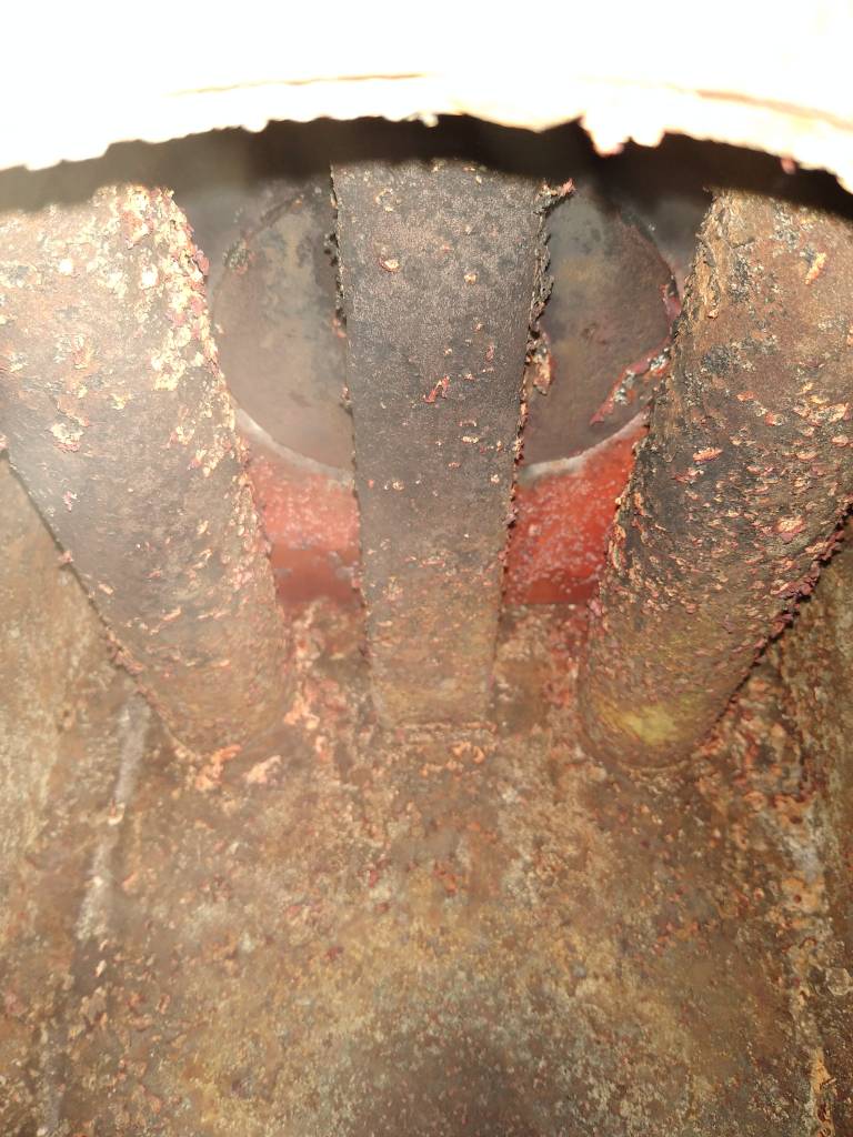

Inside the combustion chamber I was able to extract around 1kg of rust and combustion debris. I think the boiler's likely to have had next to no servicing in quite a few years. The old burner wasn't as badly corroded as I was expecting, although the nozzle has clearly seen better days.
Before Cleaning
After Cleaning

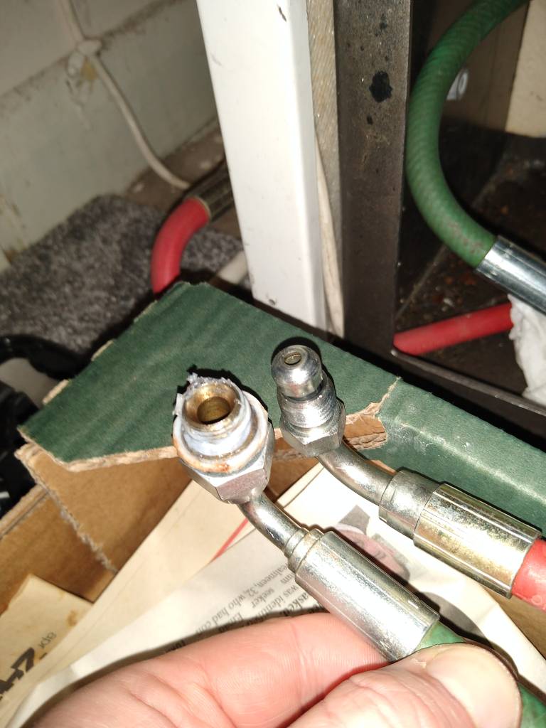

I had to get a new green flexible fuel supply line as the one fitted was a hydraulic hose of the correct 1//4" thread but without the normal male stub, so whoever fitted it had sealed it with a massive wrap of PTFE tape. I'm surprised it hasn't leaked.
