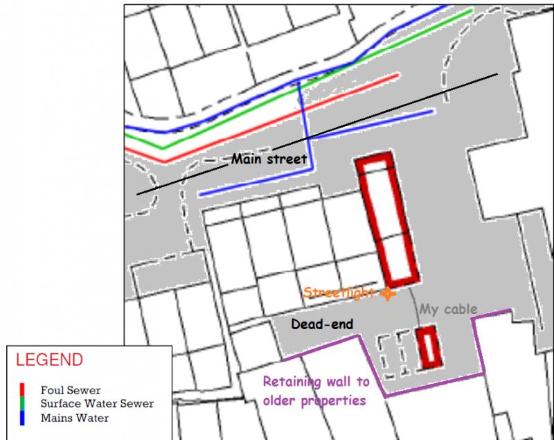

THis is from searches when buying the place. Our house and garage highlighted in red, behind us is a retaining wall to the rear of houses on a different, much older street.
It doesn't show electricity but does show how water pipes are laid up the main street as you'd expect. I'm certain mains electricity and gas is the same, the one wrinkle is the streetlight marked in orange.... does it have a cable under the houses or going round them, which our proposed trench would cross.

Thanks John. methinks I need to chase a plan. Is that something that's public domain, or would it be exclusively owned by the property management company - and are they obliged to show it?
It seems pretty unlikely that the cable to the streetlight would go under the houses - so it would seem much more likely that it goes around your house - as you say, right across the path of your proposed trench!
I don't know the answer to those questions, but, even if you could get a plan, I don't think you could take it to be giving anything more than a general idea where the cable goes.

Utility companies have access to plans of services.
These show where 'known' services are located and their depths.
Even armed with these, working gangs will always use a scanner as a GUIDE before they get the digger started. The scanner might determine if anyone (like you) may have laid in a cowboy service, but its not a 100% test.
You can hire them by the day, but you'll need to know how to use it.
