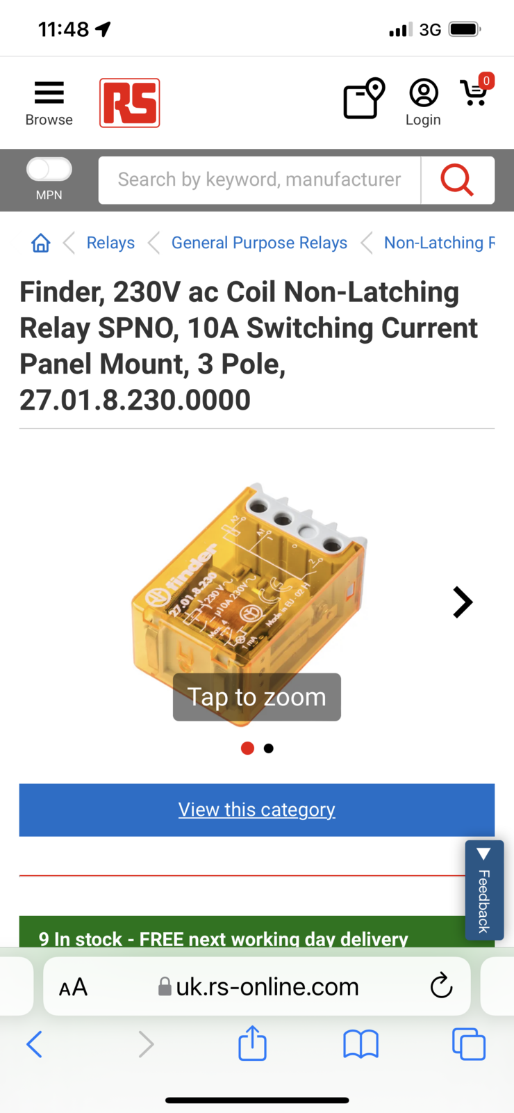

Thanks but they are to big.
Any advice on this from RS.

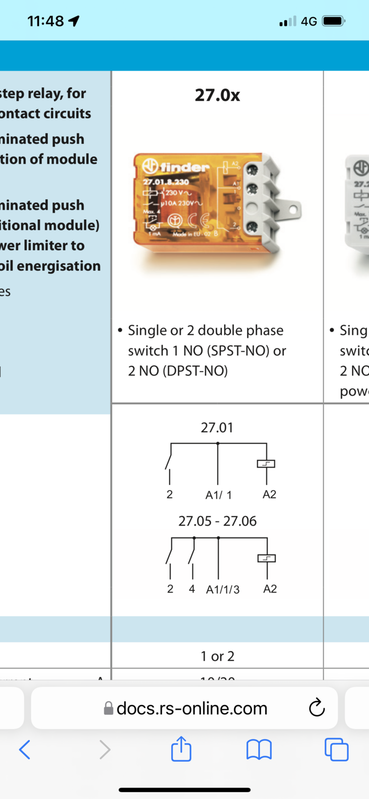

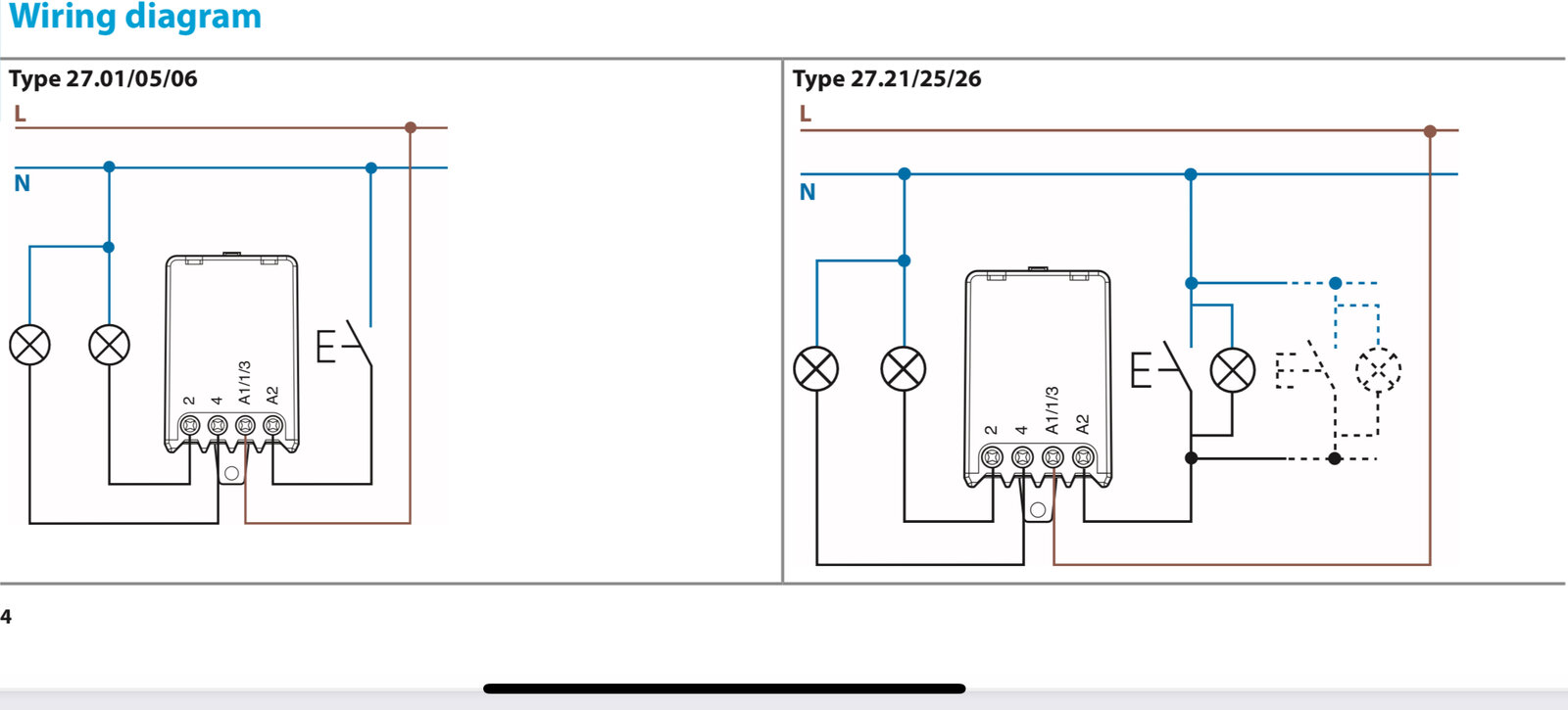

I'm not sure how to wire the switch live. As it looks like live only go's on A1....

That relay requires you to energise the coil by switching the Neutral...prob. not what you want.
Thanks, Ill have a look at the one on AMZ.
A question back to the Yellow one I posted on top, I spoke to an electrician in TLC this afternoon and he sugested I might be able to reverse the Live and Neutral and would end up with the same outcome, ie switching the live instead of the neutral, any thoughts?
That RS one will work. But not very well.
The live from the relevant controller goes to A1/1 and to the boiler.
Neutral goes to A2.
The live to the UH pump connects to 2.
Problem you will get is if one or more of the other heating zones comes on when the UFH is on it will latch that relay (so UFH will continue to run even though the controller is not calling for heat), relay will stay latched until all the other heating zones are satisfied.
This is a standard problem caused when you use the line energising the relay coil to power whatever the relay is switching. Problem is avoided by using a permanent live at the relay COM contact(s) and only using the coil line to energise the coil.
