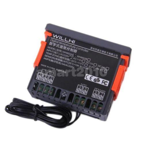

I have a also got one of these (or very similar) to control everything:
http://www.ebay.co.uk/itm/181106804925 - this item I understand and have running.

No - if you don't have a wiring diagram or other information on these two items, then there is no way that anyone else could possibly know anything about them or what you intend to do with them.
You also appear to have a 110V AC thermostat, and a relay which has a 12V DC coil to switch a 240V AC load - unclear how those items could work together in any circumstances.

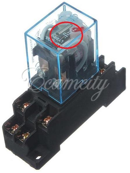

The relay from eBay:
seems to have writing on top of it, this will tell you what pin does what.

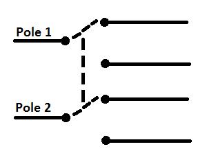

The description is "Pro 220V Coil Power Relay 10A DPDT " which means
The coil needs 220volts to energise
It can switch 10 amps
It is double pole, double throw configuration, like this:

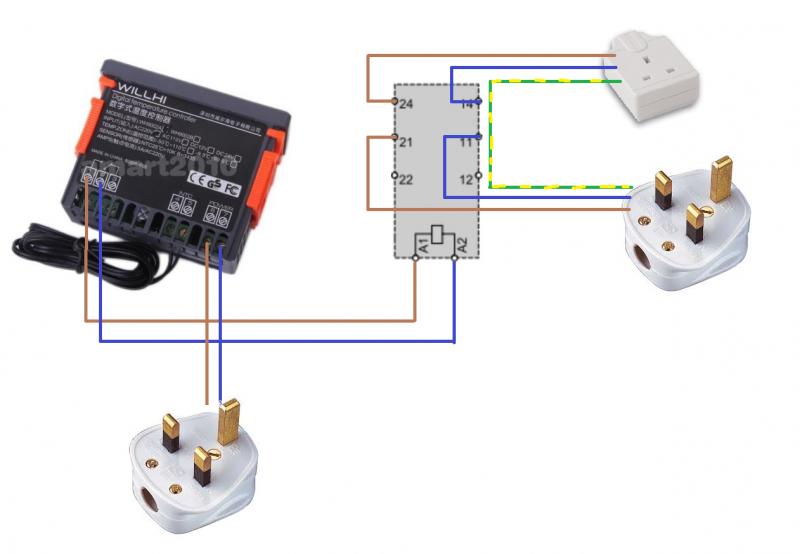

Thanks for the comments already, I'm showing my lack of knowlage quicker than I hoped.
To answer the questions, the digital control unit is 230v not 12v as show in my link, appogigies.
I've had a better look at the resistor and can't photograph suitably, but the diagram looks near identical to this:
Please don't laugh at my hone drawn project diagram, but this 'may' help explain what I'm trying to achieve....
Thanks again.
Sorry but your picture means not much to me! :LOL:
The pic of the relay however. A1 is switched live in from the controller. A2 is your neutral.
Then 11 and 21 are live and neutral in, and 14 and 24 live and neutral out to the load.
One last question. How do I work out what to wire where on the relay socket?
That relay from eBay is a fake omron relay. Do not use them as they will get extremely hot to the point where the plastic melts and fail within one week of use. I learnt this the hard way.
