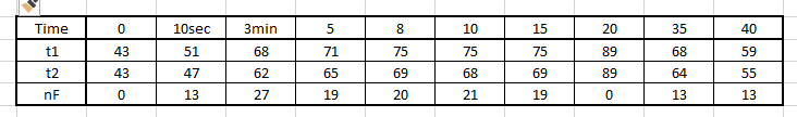

I've had the CH on for 40 minutes I'm getting the following....
Time 0 . 10sec . 3min . 5 . 8 . 10 . 15 20 . 35 . 40
t1 43 . 51 . 68 . 71 . 75 . 75 . 75 . 89 . 68 . 59
t2 . 43 . 47 . 62 . 65 . 69 . 68 . 69 . 89 . 64 . 55
nF . 0 . 13 . 27 . 19 . 20 . 21 . 19 . 0 . 13 . 13
I've had most radiators slightly (and I mean slightly) warmer than cold at the top. One radiator, at the top of my stairs was very hot, rest weren't. I can't figure it out!

I have had a look at the boiler data you posted - here it is:
The first thing I noticed was the small difference between flow and return temperatures - 4C to 7C - which should be between 11C and 20C. The boiler starts off at nF =13, which is OK. The boiler then ramps up to raise the flow temperature to 75C (standard setting in the parameters). At 15mins the boiler output reduces as the return temperature is increasing even though the flow temp is constant. Its a pity there is no data between 15 and 20 mins, but it is obvious that the flow temp has continued to rise to 89C, which is unusual as the boiler software should not let it go above 80C.
The boiler is behaving properly, i.e reacting correctly to what is happening. However it should not be getting up to 89C under any circumstances and the differential is much too small. This could all be due to the hot water circulating through the DHW heat exchanger, due to a faulty diverter valve.
