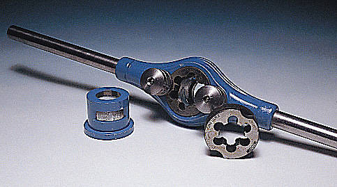

Thanks for all the suggestions. I'll have a go at using plastic conduit at the ends. By the way , I'm quite capable of putting a thread on to the end of a piece of conduit.
how you going to do that then? have you got a 20mm di set? how are you going to do it if the conduit is still in the wall? can i come and watch?
you need
to thread a 20 mm conduit
Im sure in my collection of taps and dies I could find a 20mm one. The bit of conduit in question is the one sticking up into the loft which would have be cut, isn,t it?
bet you havent ;)

how strong are you? it may be possible (only may,i have seen it done, but only once) cut conduit off, twist it round (mole grips) it may then twist, keep twisting (back and forth) and pull conduit up
this will only work if no saddles fitted, cut it off higher than required in case you can not twist it, then you can cut off the bit you just crushed with grips
