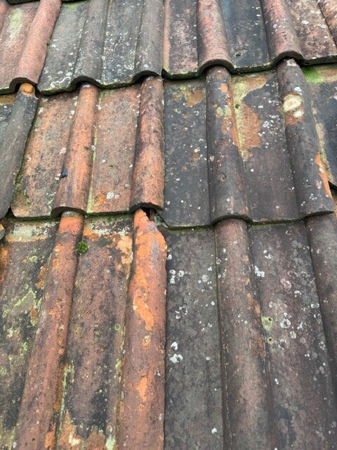

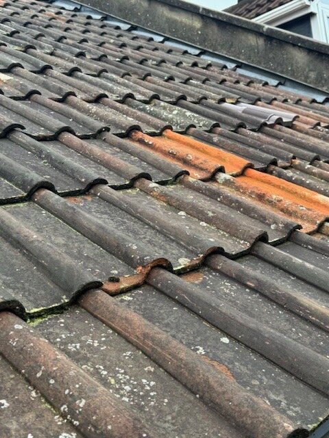

Any thoughts on reusing existing tiles and replacing any damaged ones with reclaimed? Spoken to downstairs neighbour and looking like we are going to go for the full roof relay as all the repairs were adding up! Seems to be around £8k reusing tiles/ £13k new clay tiles so quite a difference!

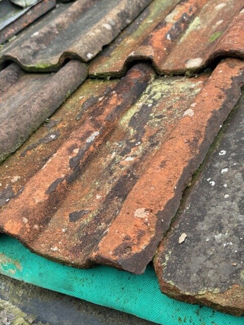

A roofer worth their salt and with good experience will be able to estimate how far through their life span those tiles are, then you can make a decision whether to keep or not.
If you fancy cutting the felt back and taking a pic of the underside of some the look of the manufacturer wording might give some clues as to the age
The inside pic of the chimney stack that is soaking- is that related to the external stack that has been capped or the one that still has 3 pots on?
Thanks, again I’ve had mixed opinions but 2 out of 4 quotes have said to replace tiles. My cousin thought they were a Belgium tile if that gives any more clues?
The chimney stack has 3 pots on so looking to get these capped too.
Edit- meant to ask - are they ‘capped’ with a chimney cowling?
No they are not from Belgium .
Remember , if you change the tile, which I wouldn't.. there is a resale value
Thanks for your comment, can I ask why you wouldn’t replace? I’ve had a couple of roofers tell me ‘they’re well past their life’ or ‘they have seen their last day’!
