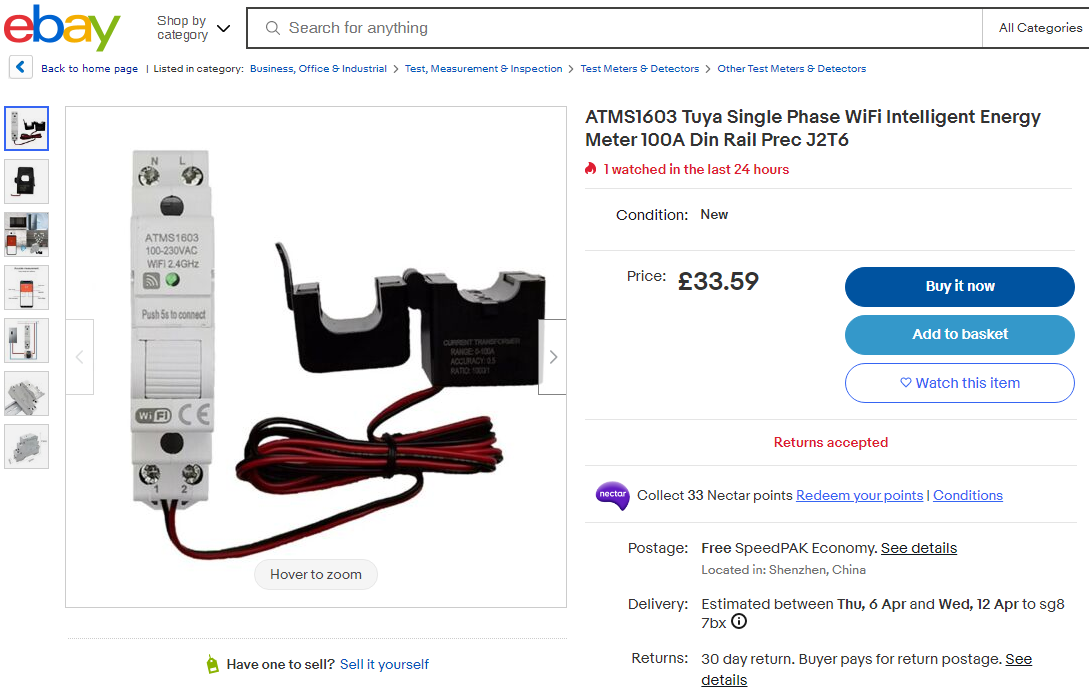

Thanks for all of the helpful advice. I wanted to install the monitoring device just to conveniently monitor usage for an electric shower, following a large electricity bill. After reading the advice, I plan to leave the consumer unit alone and instead install a monitoring device on the cable between the power switch and the shower. After passing the control switch outside the shower room, the cable goes through a loft space, so I can install the device in the loft. For now I am considering this Tuya device from eBay (see photo). It is intended for installation on a DIN rail, but I plan to put it in a separate enclosure box in the loft. I understand that the clamp should go around the live cable, so I will need to cut the outer insulation of the cable for the shower and pull out the live wire enough for the clamp to go around it. Separately I plan to power the Tuya monitoring device from a plug socket that I have in the loft. After that I will hopefully be able to monitor energy usage with an app.
You only need to place the CT, the pick up, around either the live or the neutral. Place it around both L and N, they will cancel each other out.
Probably the easiest place to fit it, would be at the consumer unit, CT inside, with the Tuya unit in a box next to the CU, but powered from a lighting circuit. Easier to fit without damaging the shower cable, easier to remove, should removal be necessary.
Pretty sure the original device is not actually an overcurrent breaker at all, theres certainly no indication of it being to 60898 or 60947-2, no breaking caapcity, no energy limiting class, no tripping curve, etc and it appears to have a 'soft' switch rather than any mechanical toggle, now while you do get some breakers that work based on electronics firing an actuator, this is normally in some of the larger MCCBs, not 1 mod MCBS.
Either the inclusion of the term breaker is a mistake in the description is a a mistake, or I beleive some places can refer to a switching action as a non-automatic circuit breaker.
While it could be installed downstream of existing protection, one might be suspicious of what the quality of construction and terminals is to be used on a high current circuit such as a shower, the second example using a CT is a much better idea, but don't start butchering the T/E in the roof space... follow @Harry Bloomfield s advice and put the CT on inside the CU, and mount the unit in a DIN enc. adj.
