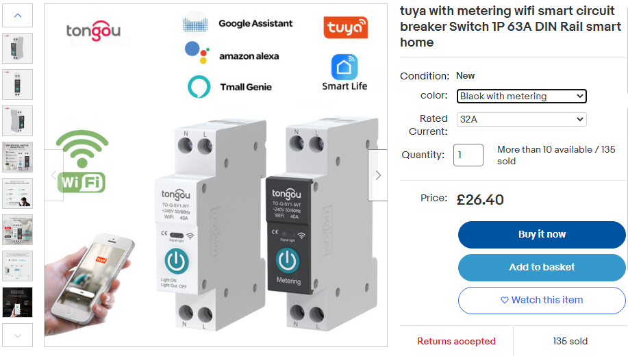

On Amazon and eBay, I have seen MCB's that have WIFI functionality which include metering and other programmable functions (see photo).
However these MCB's seem to have 2 (N&L) connections both at the top and bottom, like a double pole switch. So I wonder if they can be used to replace my Hager MTN132 B32.
Does anyone know if I can just swap these MCB's?
Can I just connect the live wire into the 'L' terminal at the top. Then connect the 'L' terminal at the bottom into the busbar?
Can I leave the 'N' terminals empty? Or does the new MCB need to be attached to the DIN rail without any busbar and have the shower circuit wired through both N & L terminals, like a double pole switch?
Thank you in advance.

These are switches (actually WiFi controlled relay), not MCB's
I haven't read all of the thread and I hope this has already been pointed out. These are switches (actually WiFi controlled relay), not MCB's
Yes, that was first pointed out in post #19 but, as you've probably seen, it has persistently referred to as a 'breaker' as well as having been called an MCB from the very start..

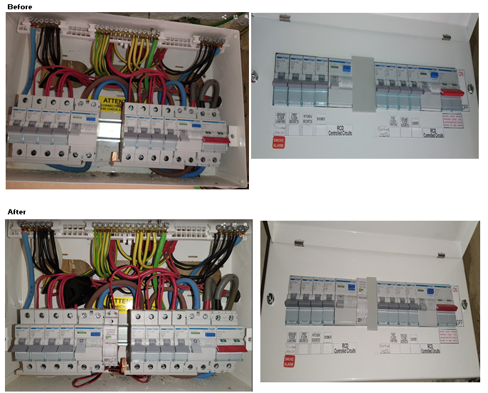

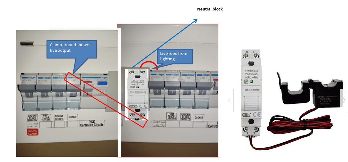

Thanks again for all of the good advice. I think that I will buy the meter device with the clamp. Would it be acceptable to wire it up as shown in the attached photo? Ie. feed a new live wire from a lighting circuit breaker. Then connect the neutral connection to a neutral block in the consumer unit? So the lighting MCB will have 2 live wires coming out the top of it (1 existing wire, plus 1 new wire).
Note that the photo shows a 'split board' with a separation shown between the two splits. There are 2 free slots in the middle available to house the new meter device.
Many thanks.
In my own house yes I would connect that way, however you ask would it be acceptable, and rules say needs to be sanctioned by the manufacturer.

Just for the record, I installed the meter device and clamp, so it monitors electricity consumption on the circuit supplying the shower. So far it seems to work well. I had to install it in a slot where there was no busbar terminal in the way. It is powered from the lighting MCB.
Thanks to everyone for their advice on this topic.
