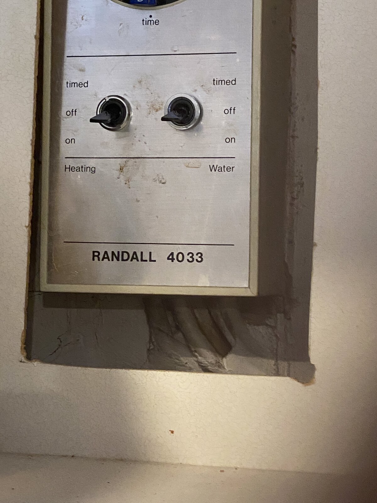

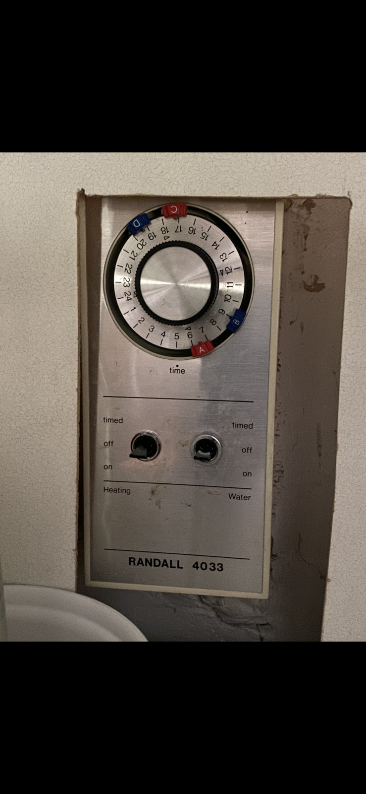

Hi, this is my first post, so pardon my ignorance.
I've not been too long at this new bungalow for my parents, there is a Danfoss Randall 4033 timer for Hot Water and Heating (click the link for pictures: https://drive.google.com/drive/folders/1zECdyqCUI5sXfGqKD2XgW1zp8M-1zDLu?usp=sharing). It looks really old and for some reason, it's been mounted about 6.5 foot up the wall inside a cupboard, hence my father who is 83 has to climb onto a chair to turn on/off the unit..... blooming nightmare and extremely dangerous at his age.
I did manage to replace the thermostat with a wireless Tado unit, which works well, but the hot water switch on the timer still needs to be controlled manually. So I've placed the order on Amazon for the Tado Extension box and that's due to arrive soon and I wanted to plan ahead to get it installed.
The Danfoss Randall 4033 has 4 or 5 wires entering the unit and wanted to know how the Tado Extension Box would be wired up?
I have a conventional Vaillant boiler with a water tank in the loft.

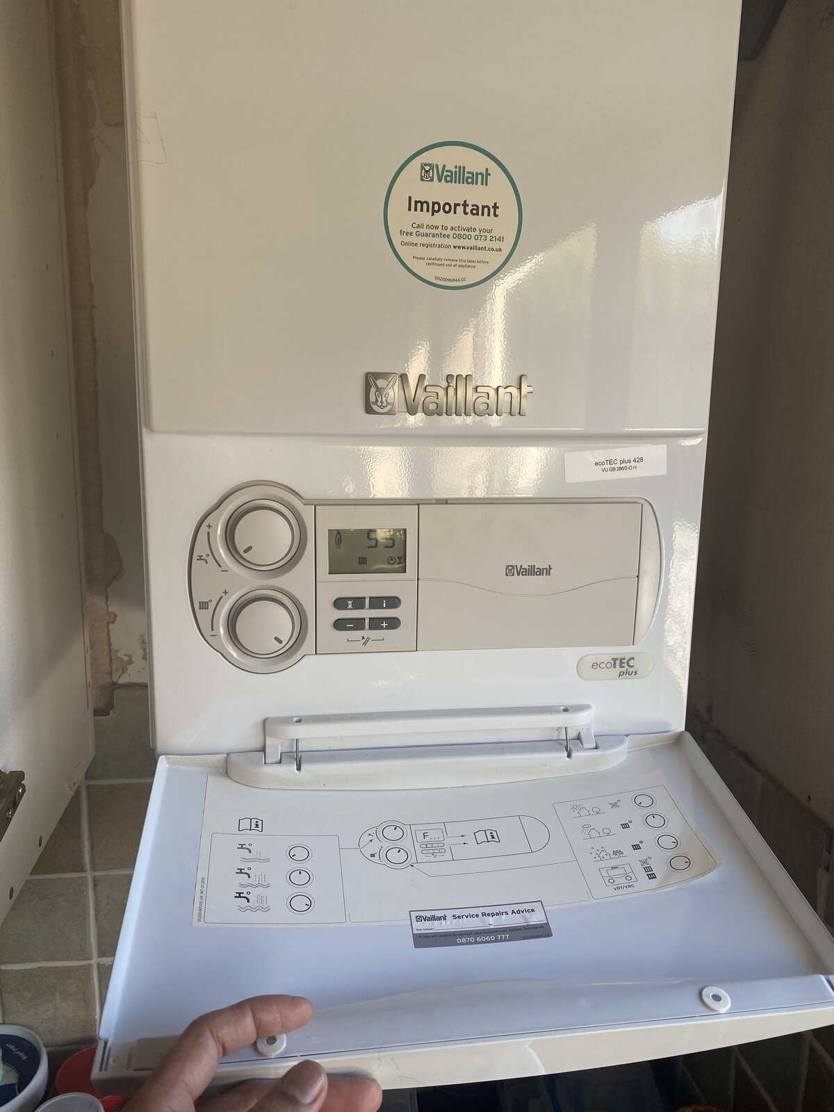

Google "vaillant eco TRC plus 428 installation instructions" and it shows this boiler uses a connection to the ebus, as with most modern boilers there are many ways to control it, so can be simple on/off, however I would suspect you want it controlled in an economic way, so the question is how much do you want to spend.

My dad uses the Tado app and he can turn on the heating and change the temperature up or down, so adding the Hot Water Controller would be ideal.
How do I figure out what S, C, Y or W plan configuration/variation I have?
Have a look in the cylinder cupboard, if you don’t know how many valves you have, post photo of cylinder cupboard
