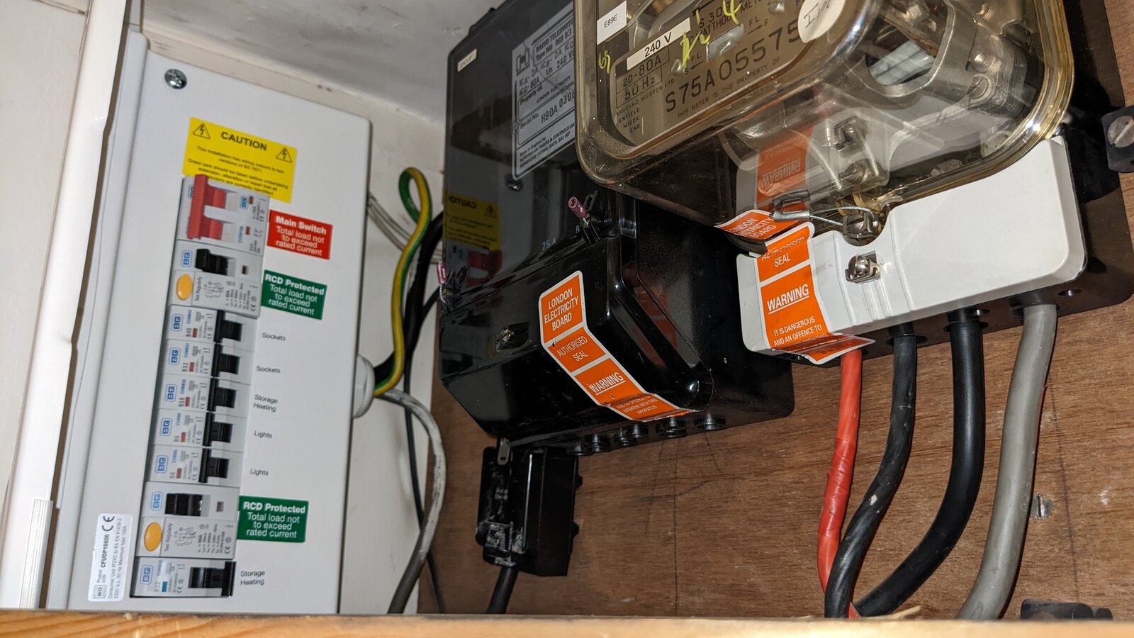

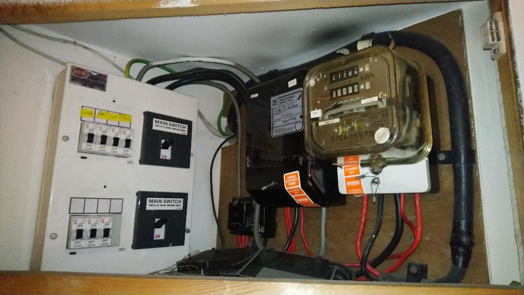

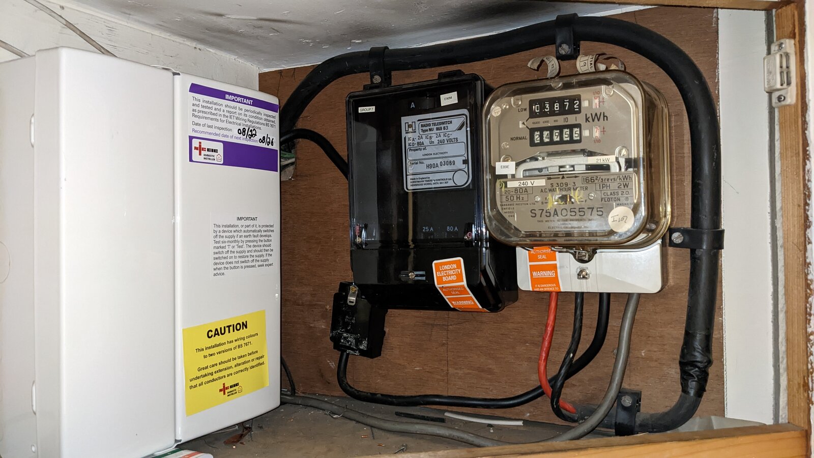

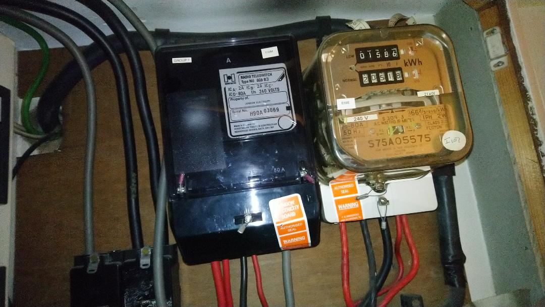

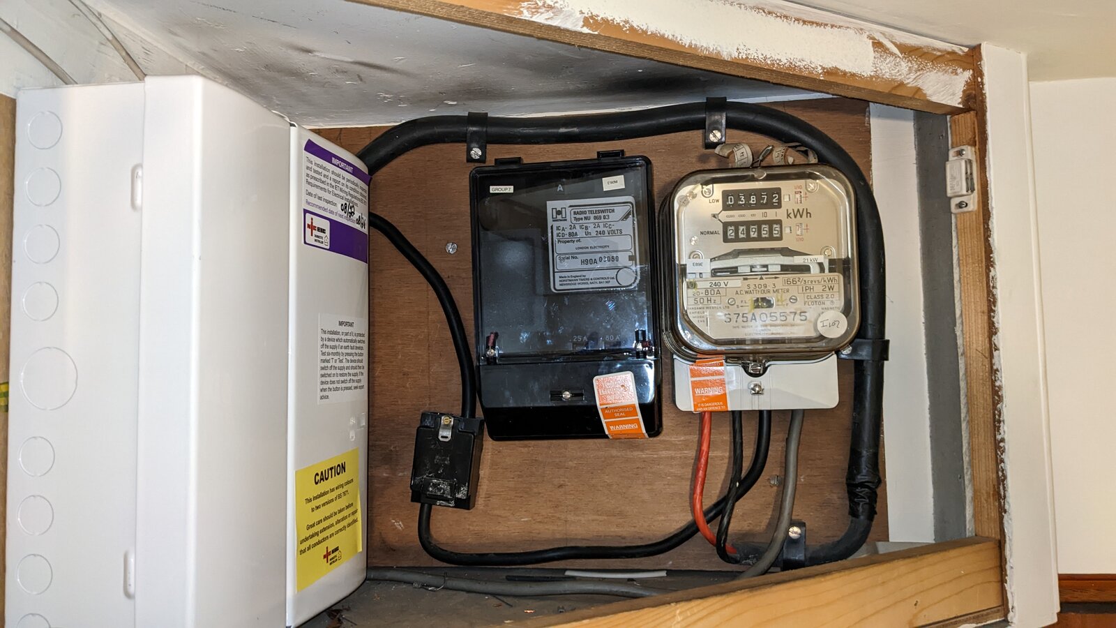

Will send photos later on when in home
Photos attached!
Oh wow I can see now the electrician that changed the consumer unit completely disconnected the eco7 ??
Yea I noticed that. Why would he have accessed the meter and the RT?? I feel like the electrician that came over to change the CU messed up a bit..
No way has he messed up, that is a complete and utter F**k*p call him and ask him to restore it or you will inform your energy supplier.
The guy is a total a*****l* for doing that to you.
Do you have a full set of paperwork and how much did you pay?
And very well done for taking the brilliant pictures before
