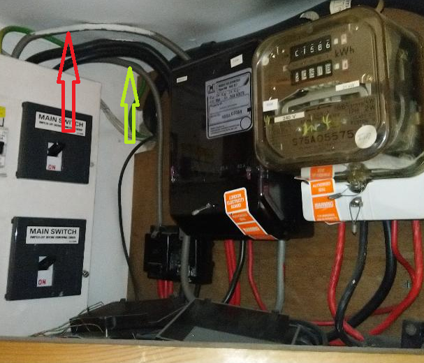

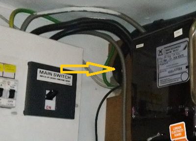

Does that dual rate meter rely on the teleswitch to change from Normal to Lower?
yes, it's this wire that does the actual switching
The really nasty thing he did to you is rather than leave it all in place and use the wire shown with a green arrow and made the wire shown with a red arrow safe everything would have fine.

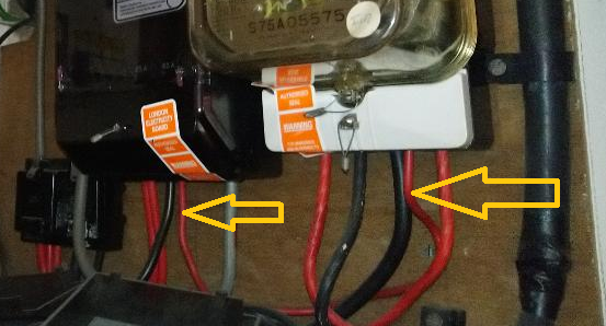

What's the cut out seal?
The cutout is another name for the service head or company fuse and it is at the distant end of the big fat black cable, probably in the basement or entrance hall etc
He could have quite easily done your job, without resorting to that. Presumably he did what he did for ease, and because he thought he was saving space.
If you didn't require the off peak supply, he could have terminated the tails in an isco block or something.
If you did require the off peak supply, he could have made that consumer unit into a dual tarriff board. To gain extra space in the board, the two RCDs could have been removed, the MCBs substituted for RCBOs, thus leaving room for another main switch for the off peak, and any additional circuits.
Get him back.
Yes, there is a switched output from the teleswitch to the meter to change to the second register.
As configured now, the teleswitch will do nothing as it's not connected, and the meter will record 100% of use at the high rate.
