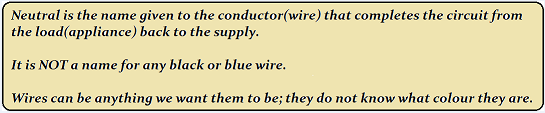

Lesson 1:
I'm not quite sure what the point of that "lesson" might be. Maybe you should re-read my question. I know the difference between neutral and earth.
The current switch has no earth: there are only 2 wires coming into the back box, live and neutral.
It is not a neutral, it is a switch wire. Many/most/all timers will need a neutral to power the timer. Unless they are double insulated, they will also require an earth too
