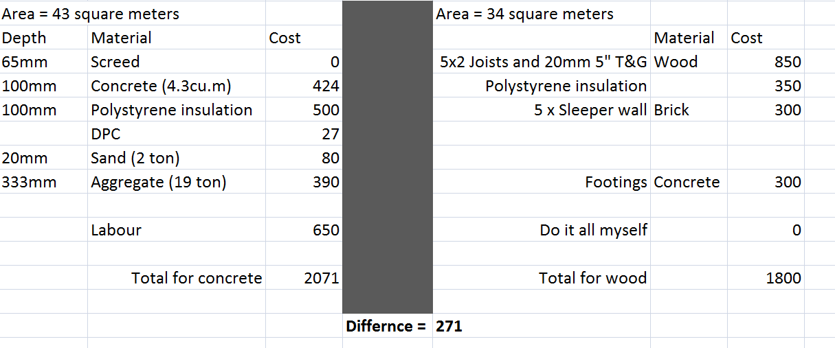

attached is a revised price comparison-the difference is not that great. I know it will cost a bit more to finish off but it will allow me to get on with other works sooner...
Why are you so much in favor of wood floor and not concrete Doggit?
