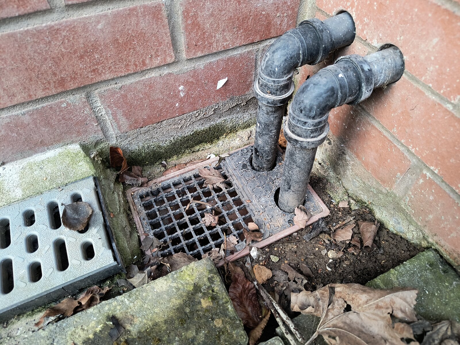

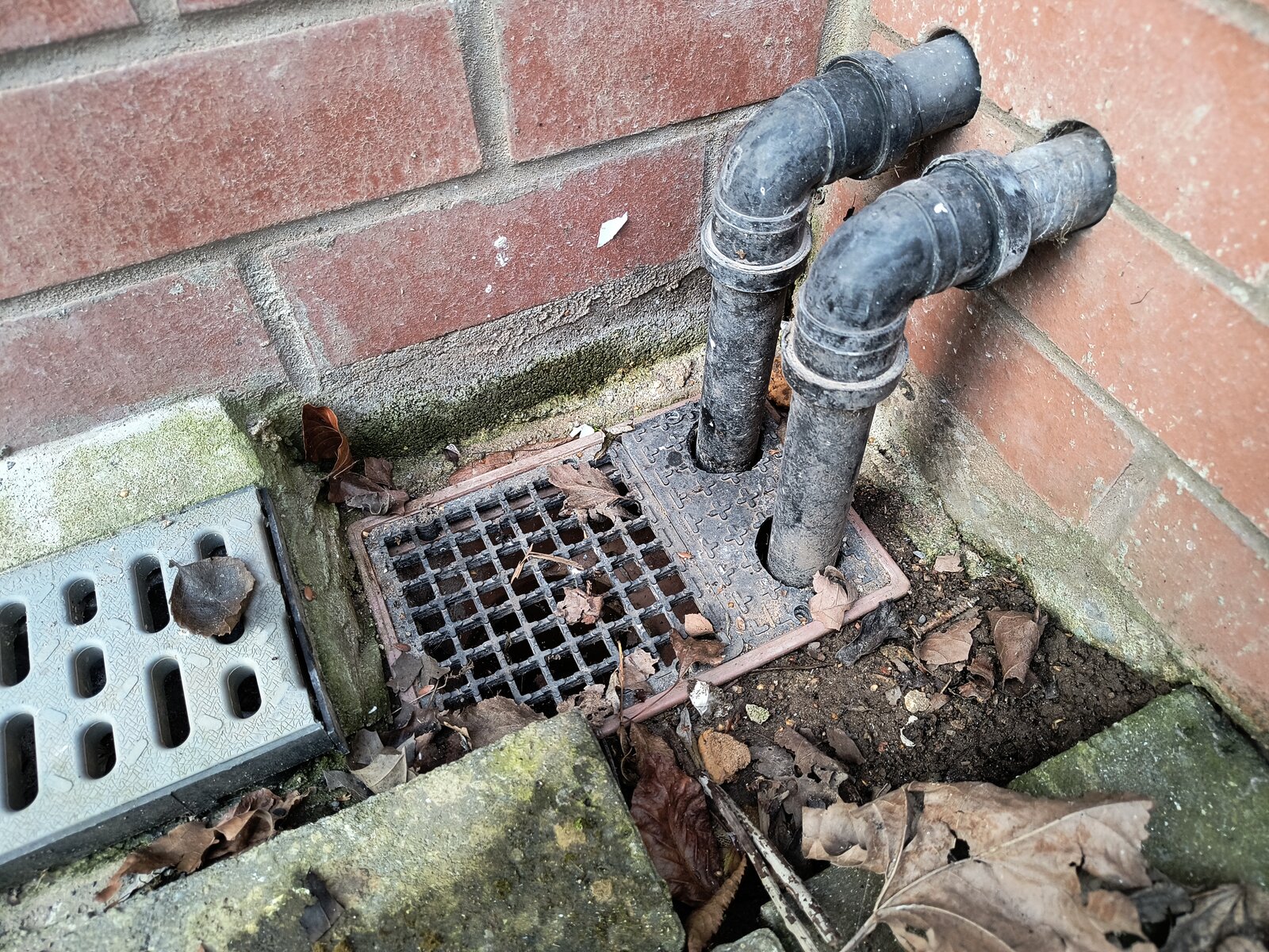

I have these, obviously I put the holes in myself but I think that's the idea. There's an outside tap above the pipes which hits the grating pretty well. I will of course be haunching or flaunching round it at some point.
I've put all pipes through the covers including rainwater, after seeing all the water spraying straight across it and spewing all over the place when it rained heavily. The same when the washing machine empties.
It can be done while leaving the cover removable. Anything that could fit into the waste pipe definitely isn't big enough to block the gully.
Me too, including notching the cast-iron grids, to accept them, all except the rain water ones, but they don't cause much of an issue, leaves don't usually get in the gutters, to cause much of a problem.

Same here, so I bought, and fitted some of those cheap, plastic covers, cut to a tight fit around the pipes.
I made one out of flat sheet aluminium so it sort of matched the colour of the surrounding grey concrete slabs ---- cause i am like that :p

Some gullies have a back-inlets, some have an extended hopper to allow for off centre pipes ingress etc. The problem is with gullies with a pull-out sleeve and such things as solvent welded waste pipes, is cleaning out the trap (lifting the grid and pulling out the sleeve) can be a ball ache if waste pipes are obstructing. We've had to buy a compression 40mm or 32mm connectors in the past, whereby we've had to cut the solvent weld wastes and repair them with a removable connector.
Not a problem here, mine are either push-fit at the ends, or the grid comes out with disturbing the pipes.
The one in the OP's image has a pull-out hopper and a pull-out sleeve though. And those pipes above it are solvent weld. The sleeve needs about 150mm of vertical travel, to be able to remove it.

Grates are not one-touch removable if pipes are going thro them.
